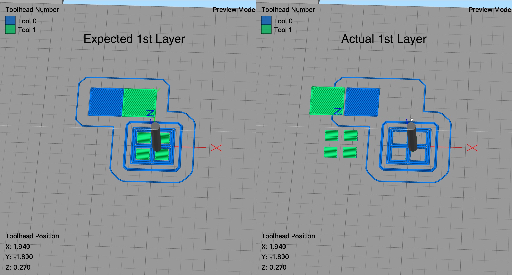

Good afternoon,
I am trying to print the above and optimise print quality using both extruders. (I understand this will increase print time substantially so don't worry about that).
In Simplify3D and other online Gcode analysers, the model looks correct (with prime pillar and ooze shield included).
However, when I actually print the model, the PVA layer has been shifted to the left. SEE IMAGES: Expected 1st Layer vs. Actual 1st Layer.
The G-Code is set in 'absolute mode' (G90). Yet, it is as though, when the Tool Change script is initiated the machine loses or maybe resets it's y0,x0 coordinates, and when it repositions to start printing again... it doesn't match up to the previous positioning. I'm at a loss.
Any help here would be greatly appreciated.
