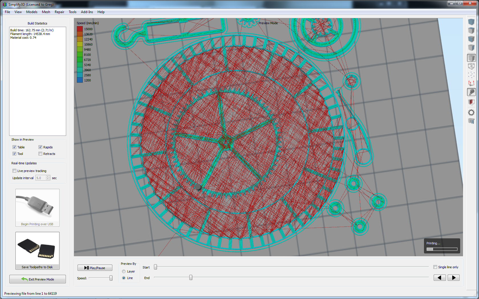

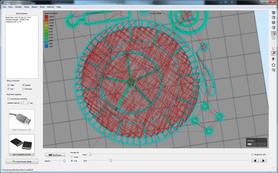

gadittri
Posts: 14
Joined: Wed Oct 29, 2014 3:18 pm
Re: Feature request - Finish all shells before move.
+111
This is really a problem with Bowden system having to perform hundred retracts per layer. It is really painful to watch the nozzle move 200mm because the software decided it needed to extrude a few mm of plastic on the opposite side of print and come right back.
Shows the extreme amount of moves
