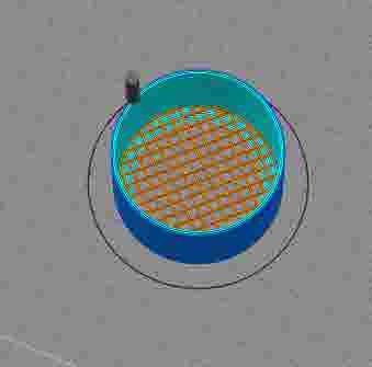

... the area you want to print so, must be a separate STL in a own process like Dual-print.
Or you must adjust your drawing as a grid.
If you want to print e.g. a filter from a solid cylinder or solid cube it suffers to set
- process 1 >>> perimeters high (e.g.10), NO bottom, NO top layers, Infill e.g. 15% Stop in Advanced at e.g.2 mm
- process 2 >>> perimeters low (e.g. 3), NO bottom, NO top layers, infill set to zero, Start in Advanced at 2 mm as high as you want
You get >>> have a look to the picture.

horst.w wrote: ↑Tue Oct 08, 2019 3:26 am You get >>> have a look to the picture.
Hi, @horst.w Thank you for sharing your solution!
