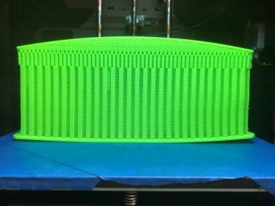

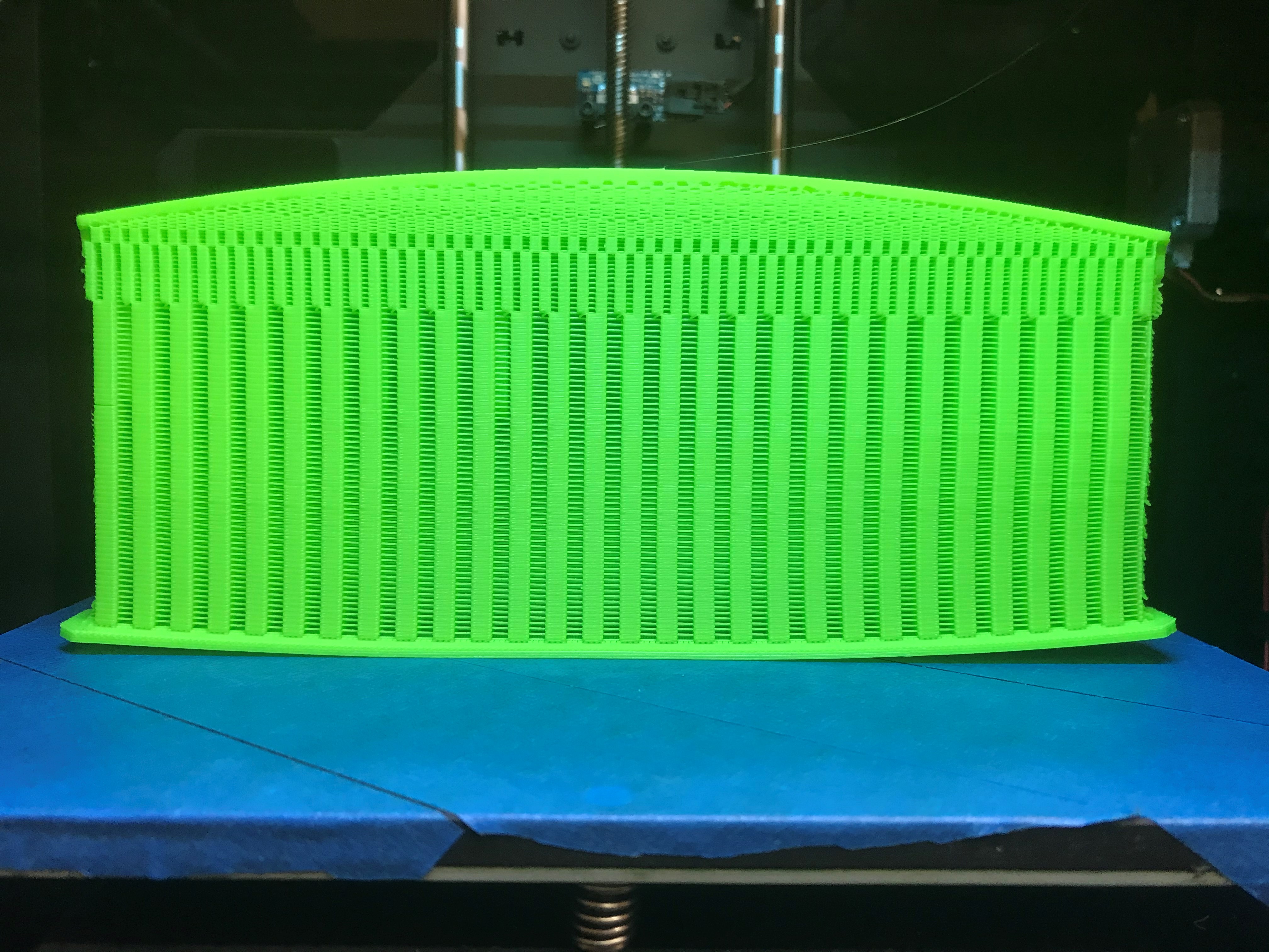

The finished part was really very good concidering the ends were lifting off the bed after about 2 hours into the process. Not sure why it did this as it was enclosed inside the unit, so no draught was getting to it. See attached images.
I will continue trying to model it flat if I can. I don't see why it is not allowing me to do so, there must be a setting that I need to adjust to achieve this.
Thanks again to both for your good suggestions.
