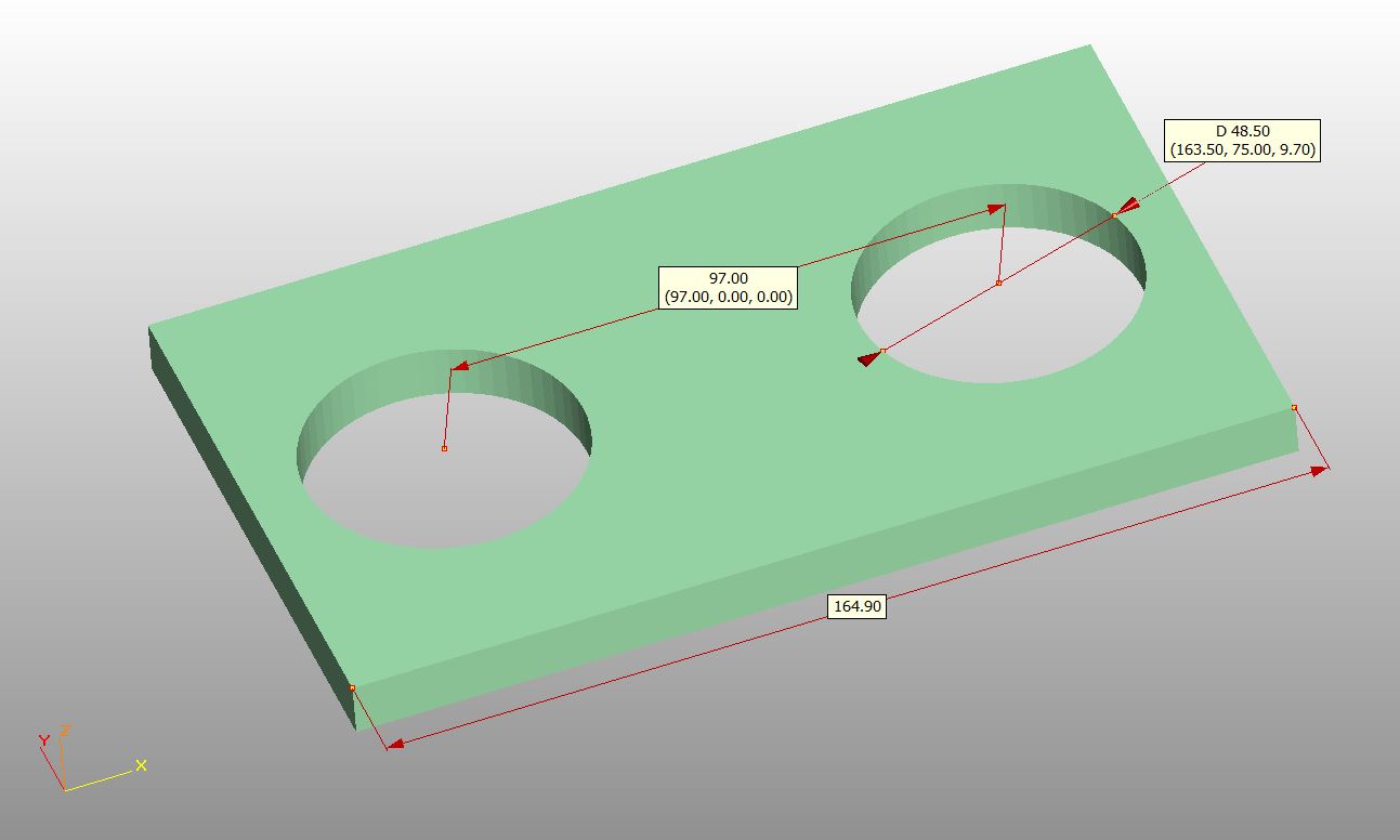

Omikron wrote: ↑Fri Oct 02, 2020 5:08 pm 3. Regarding the horizontal size compensation, is there a way to input a percentage? Inputting a value in mm is not helpful considering different models will have different values here.
If your model shrinks by let's say 3% horizontal size compensation won't fix that, that's not really what it's there for.
Example:
Assumed shrink by 3%:
To get the holes (48.5mm diameter) up to their original size you'd need to use a negative value. But this will also further reduce
the outer dimensions of the part (164.9mm wide).
And even if this would work somehow - it wouldn't fix the two holes now being too close to each other (97mm instead of 100mm).
