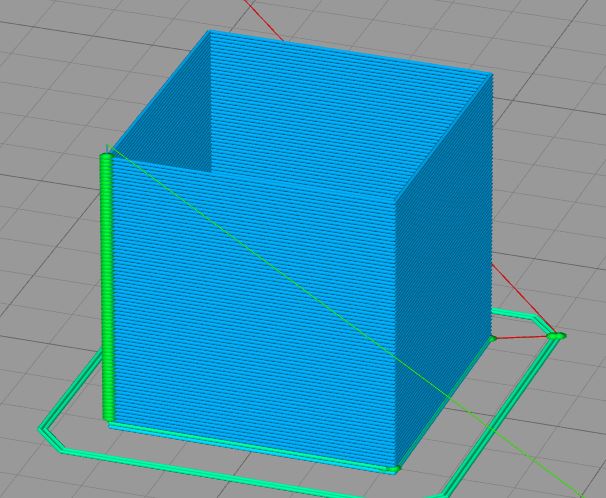

Also stairs height seems to be 4 layers height and retractation occur on each border every 4 layers ( according to simplify3d preview ), so maybe related to retraction or over extrusion as you mentionned, dont know I already lowered extrusion to 0.9...

It is maybe something related to slicing (Simplify3D) because I notice that the nozzle go twice at the same location exacly every 4 layers, and stair's are every 4 layers.
I mean there is maybe something wrong on the slicing, because it go on the outer perimeter, draw it, than get back at the same location it started rather than a bit before, so the nozzle print twice at the location it started the outer perimeter.

The dots on the preview picture are the points showing the retracts. They are only visually . You can check it off.
