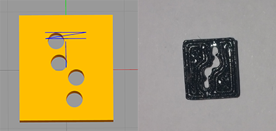

Hello,
I am new to 3D printing so I use the default configuration offered by simplify3D for my printer (FlashForge Creator Pro).
I'm trying to print a very small piece (7.5mm) with close holes without accurate results (see attachment)
Any suggestions on which settings to use for small impressions?
Thank you !
Tiny print with close holes

Sorry to say but I wouldn't get my hopes up for a print that small with those tiny holes, but I'll guess it all depends on your expectations. Although you should be able to make a better one than that on the picture.
What nozzle size du you use?
And a better closeup would be nice :)
Re: Best settings for small prints
It should be possible to get better results....that's not an impossibly small part...by a long way! See here: viewtopic.php?f=8&t=14049
Attach a factory file for this part, please.
And what material are you printing in?

Thank you for the Factory File! After looking over your Process Settings I would suggest printing slower and at a lower temperature to start out with. 3600mm/min is pretty fast for such a small part and 230 is nearing the upper range of what PLA usually prints at. Is the picture you included only one layer of the print here?

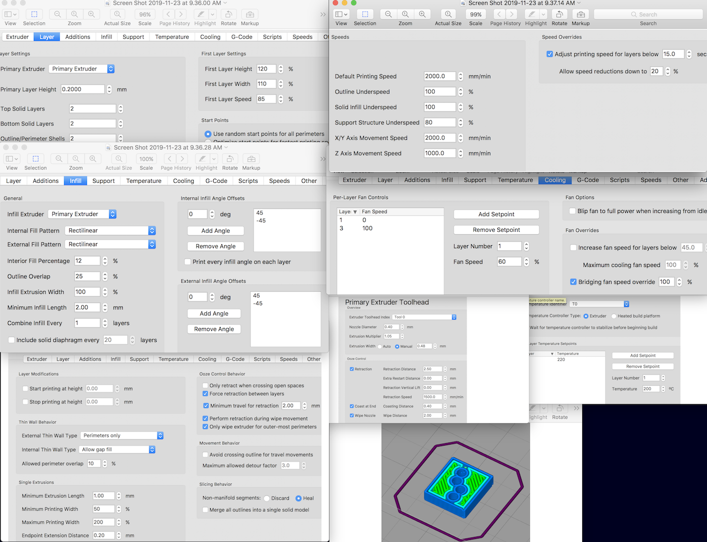

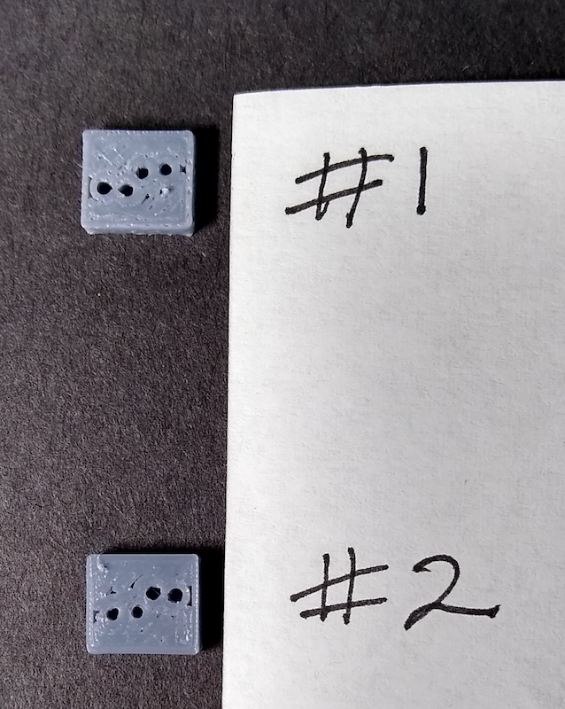

Printed your part using:
#1) my default settings (shown below)
#2 Adjusted layer height to 0.1mm, Top/Btm layers=3, shells=2 unchanged
Printer: Prusa built from a Kit, 0.4 nozzle
PLA: esun
Results: in both cases, printed as shown in photo
Nothing else was tweaked. I’m certain I could get a perfect print if spending 5 minutes tweaking...
Note: I adjust bed height using thin cigarette rolling paper to ensure good ‘Squishing’ of layer1 onto bed glass.
