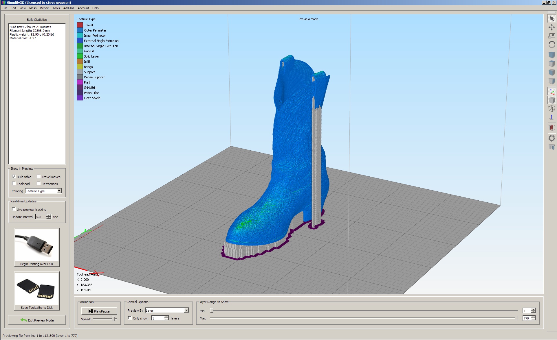

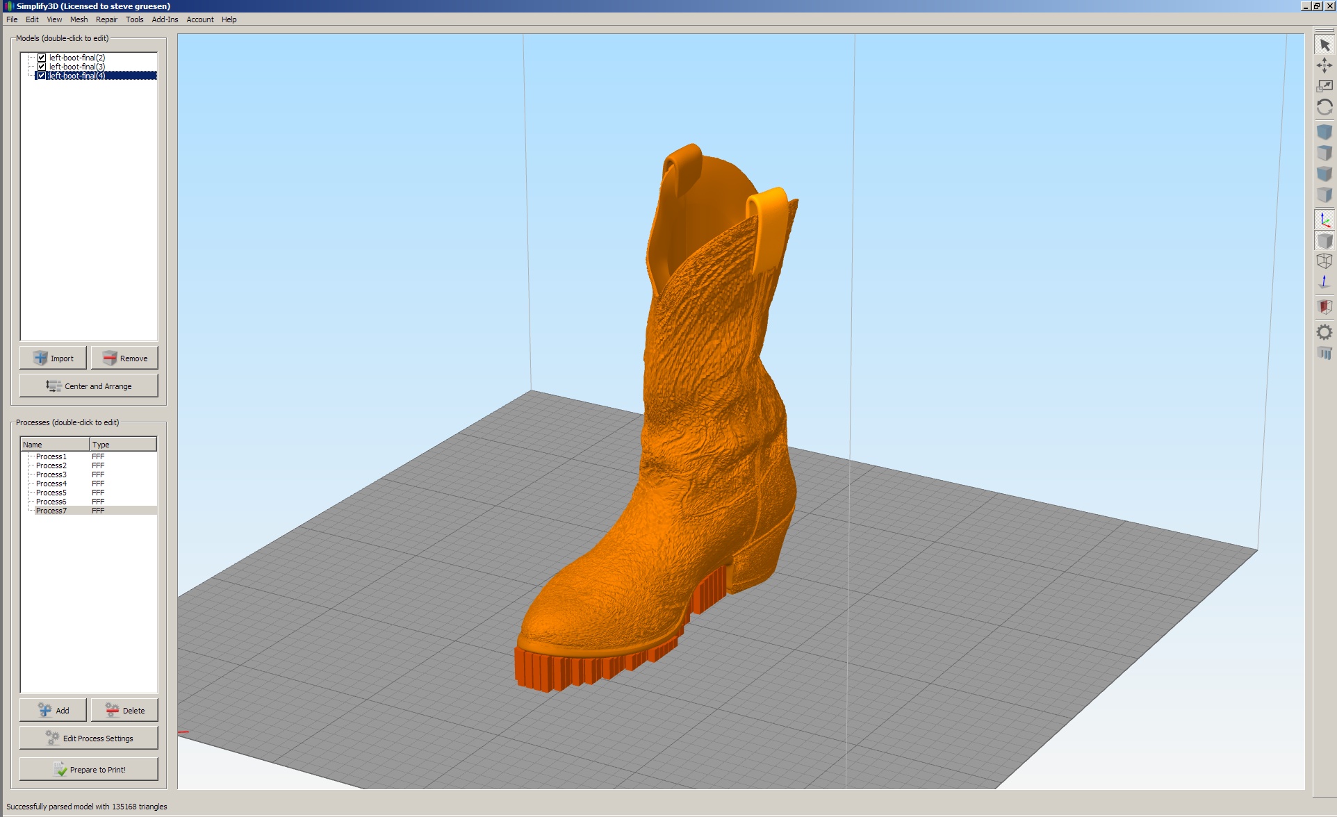

since i can't get the factory file uploaded due to size, here are two screen shots that might help.
Re: custom supports with multiple processes
I think I have an easy solution......change the Support Pillar Resolution in all your processes to 99. This will stop any parts that have no manual supports from having automatic supports generated for them.
I have this set at 99 as normal......and only drop it down to a realistic value when I need either auto or manual supports. Its a more reliable way of switching supports off!

hey that fixed it! thank you! shaved 30mins off estimated print time too.
