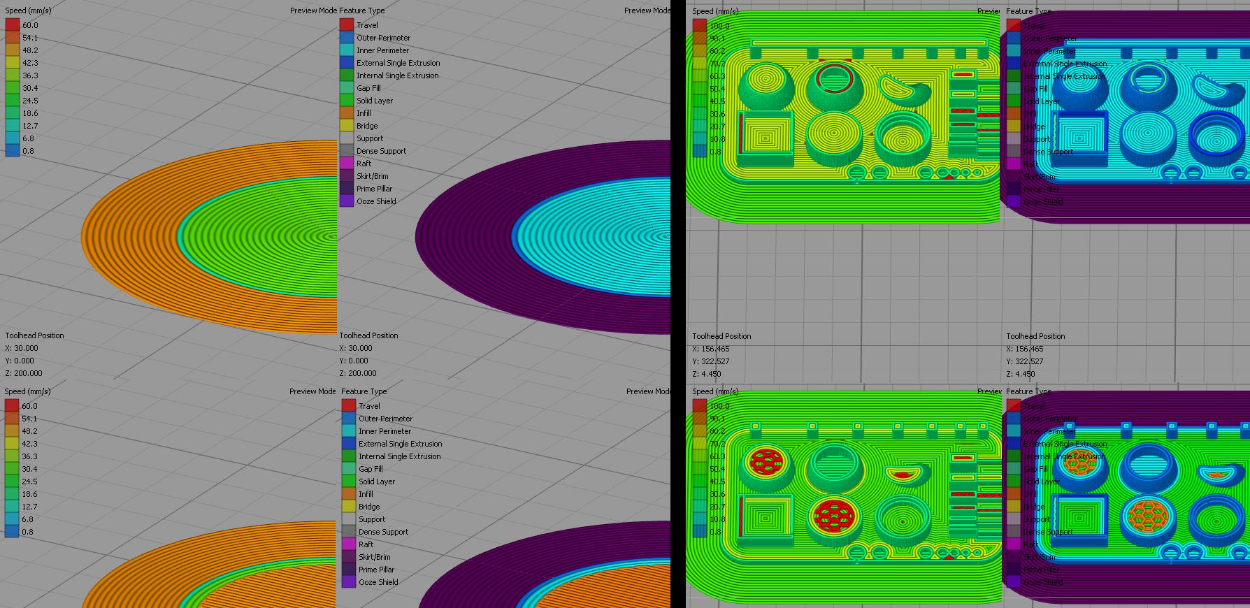

The only thing I can do right now is keep speeds very low. Adding this system would allow me to increase over all speeds. I could very easily create a video of exactly the behavior I need throttled. I think this could be dealt with far easier in the slicer than the Firmware. Though the firmware already tries to deal with similar issues, such as sudden changes in direction.

Finally starting to get some solid results with V5. I am able to test changes, for better, for worse.
One I can report does seem to be for better is what does seem to be the inclusion of a function that is behaving very much as requested. Though as far as I know this was never marked as a planned inclusion.
I can see as the radius of the circle gets smaller, there is a marked decrease in RPM. If this were to remain constant the motor would continue to spin faster and faster into the center was reached. At least from our perception would be faster since each circle would take less time to lay, at the exact same print rate. - Since this observation also followed a Firmware bump, there is a chance it is tied to firmware behavior. But as far as I know, it is not.
I wonder if this is linked to Reduce speed for short perimeters, since I use the perimeter multiplier as a way to create controlled and uniform concentric infill.
For certain this is not high flow rate or a quick layer.
-This would linked successive lines or arcs, where is there is no reversal or change in direction greater than 72Deg.
Posts: 1566
Re: Dynamic reduction of speed
Yes, V5 added the ability to print short perimeters using reduced speeds. It's helpful for small holes, embedded text, or anything similar.
You can see the new feature described in the "Targeted Build Customizations" section of the V5 announcement page. It's also mentioned in the release notes.
https://www.simplify3d.com/products/sim ... rsion-5-0/
If you set the preview to Movement Speed coloring, it should be easy to see that this setting is having an effect.
