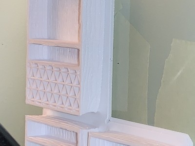

I am having issues with Warping and I cannot any of the models I am printing to stay flat.
Here is a picture of the issue:

I've been working at it for a few days now as this print takes 12 hours. To me, it seems like the model shrinks as the extruder gets higher. I have followed the quality guide, and added a skirt/Brim, and I added a fairly thick raft. For some reason, its still pulling up.
There is some major improvement, but its still not resolved.
Any input on how to fix this, would be greatly appreciated.

Looks like you're printing on a raft. Reduce the separation distance to improve the bond between the print and the raft.

You have quite a lot of other issues going on with your print besides just warping. You seem to be having retraction, extrusion and temperature issues.

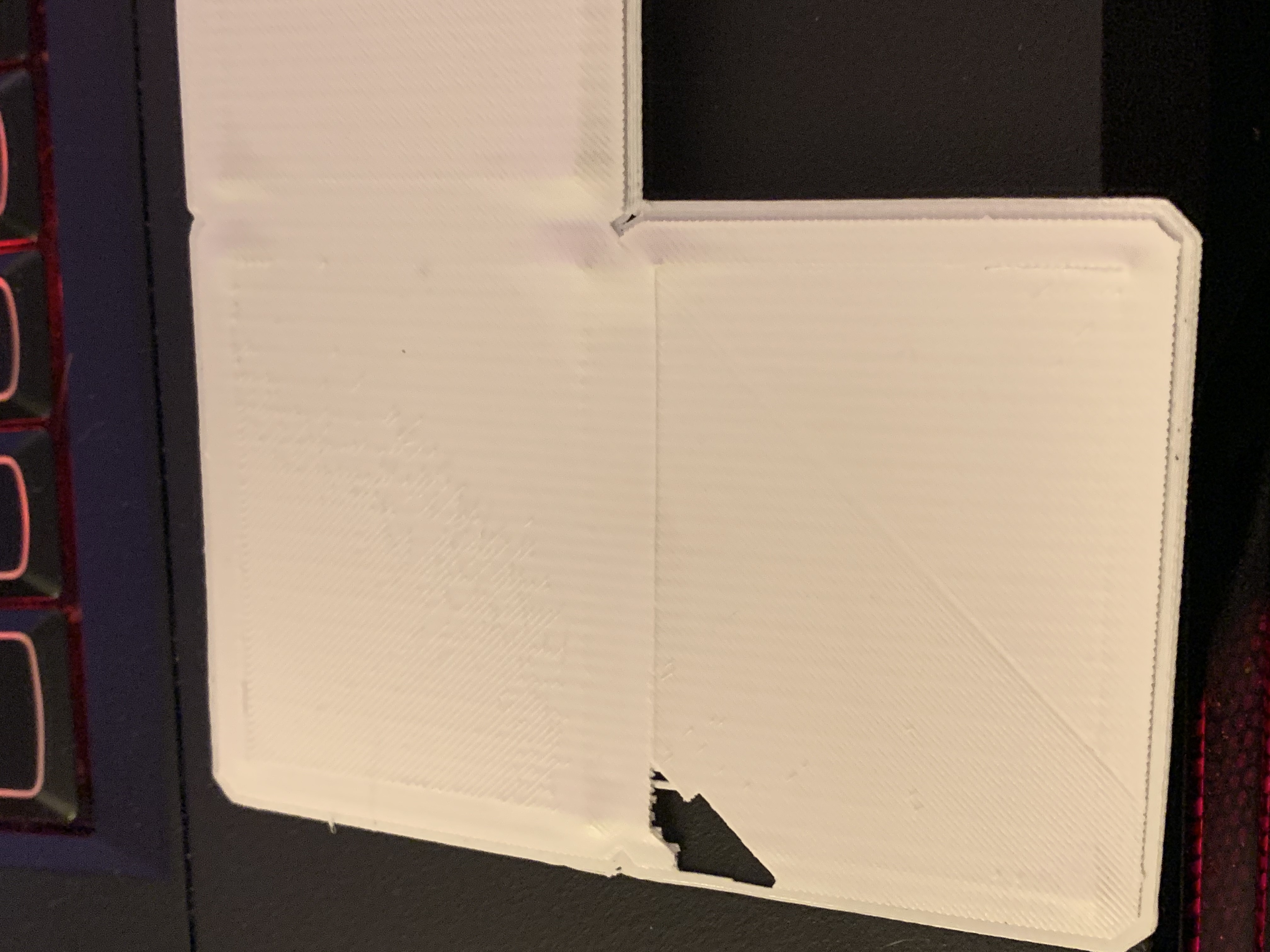

This is the raft after the last print:
To my inexperienced eye, it seems like the raft is pulling up on those corners as well. I don't believe at this point, that its anything to do with the separation layer.
I also started a new print and I'm letting it run for now because the physical piece its printing seems to be coming out okay. However, after a short way into the print, the edge of the raft pulled up. As of now the piece seems to be uneffected:

zemlin
Posts: 434
Re: Warping issue
Looks like things are running too hot. I run PLA with all the cooling I can get on the part, doors open on the printer (mine is enclosed) and top removed - mine is also in the garage so the ambient temp is low during the winter. You might try a fan blowing at the machine to help. I don't run much PLA, but that's my thought from all the wavy edges.
