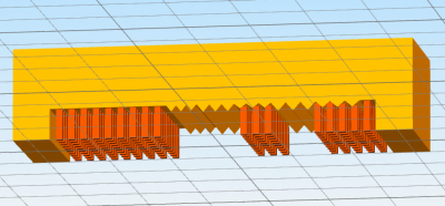

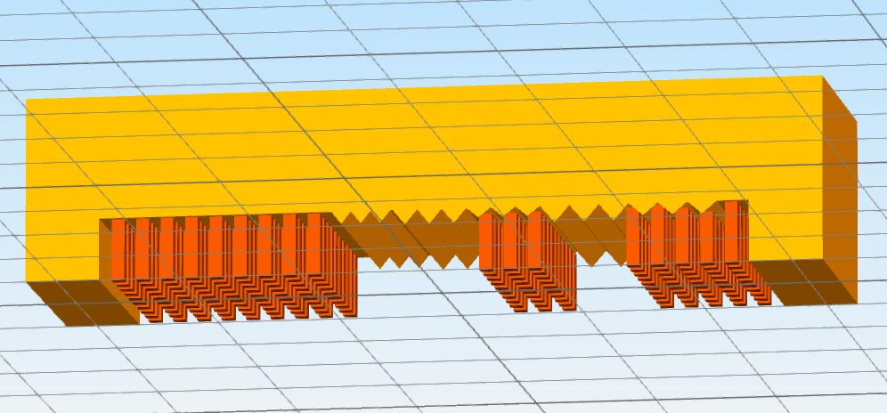

The automatic Support Generation algorithm gets fooled into omitting support for downward-pointing peaks (which must be supported), when the faces adjacent to those peaks are at > 45 degrees from horizontal. The attached image shows this case.
