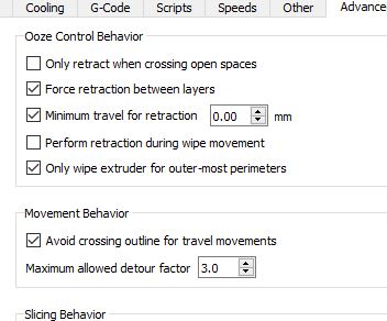

I've reviewed your profile and I suggest the changes shown to Ooze control & Movement Behaviour as per the fo;;owing screen snap:
If you switch on travel movements in the slicing simulation view before you make the changes, you'll notice the vertical lift taking place with the changes.

by freakaccident
This fixed it! Thanks Doug!
