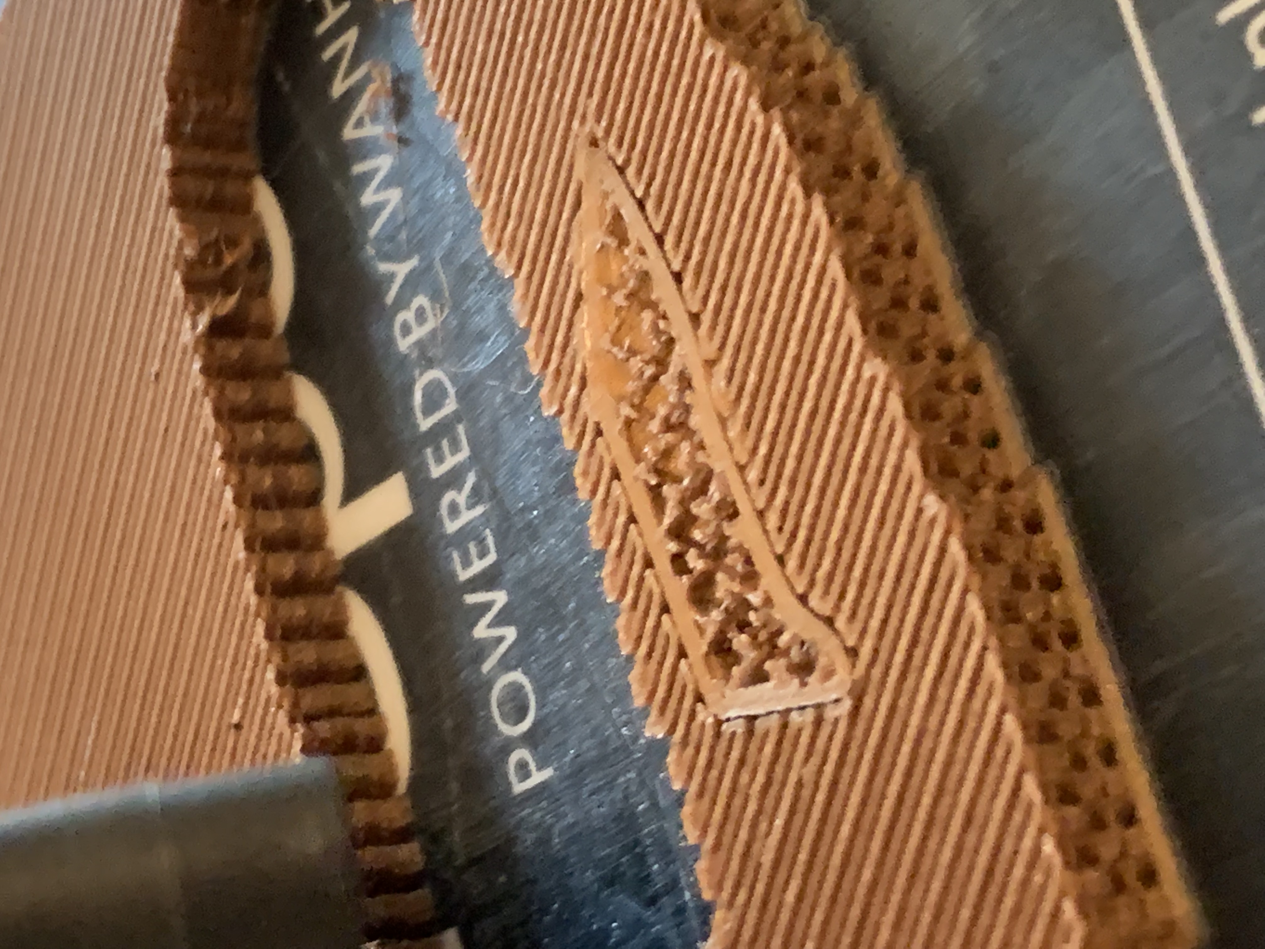

1. Weak infill. I’ve seen many other posts about this. I attached a picture. I fixed this by increasing the Infill width to over 200%, but then it uses more filament and takes more time.

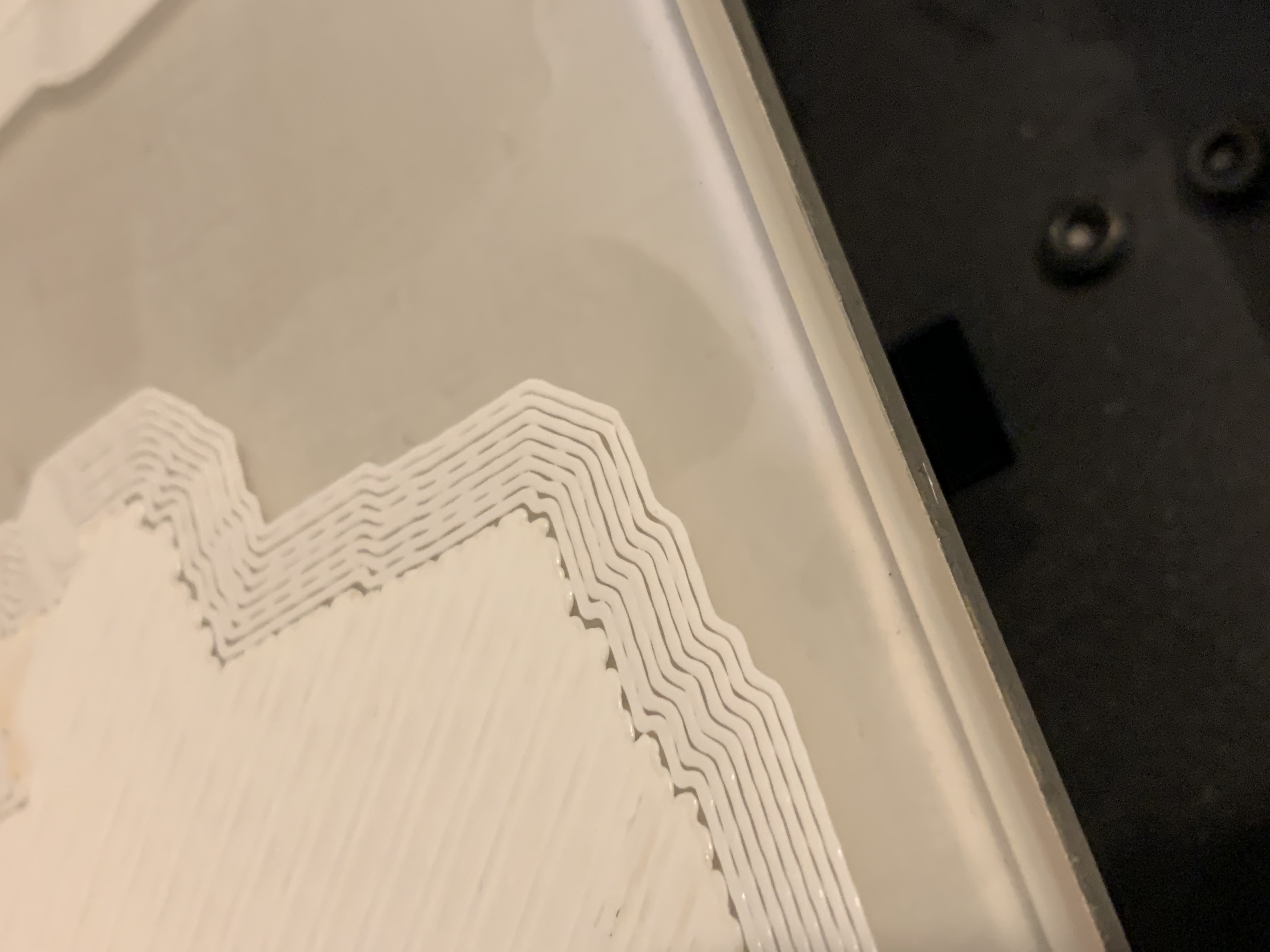

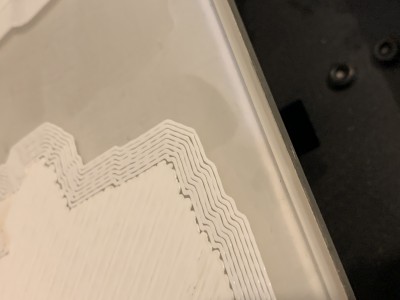

2. Brim doesn’t attach to model or other lines of the brim even when distance is set to zero. (Pic attached). Haven’t figured out how to fix this yet.
