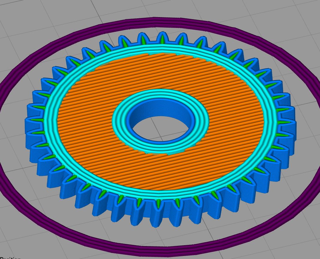

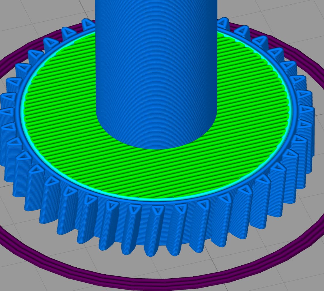

So I'm trying to print off a couple replacement gears for a hand mixer. Near the top of the splines, they're printing as separate islands, as indicated in the image below. Anyone have any ideas on how to force the outer perimeter to be a single extrusion, as it does further down the splines?

I think you need to go back to the CAD of this gear. It appears not only to be made up of 767 separate elements, but the teeth, having been made separately, do not overlap the core of the wheel fully...and are seen by the slicer to have a very, very small gap between the tooth and the core of the gear.....as if they're placed butted together and not overlapped.

dkightley wrote: ↑Thu Apr 09, 2020 4:58 pm I think you need to go back to the CAD of this gear. It appears not only to be made up of 767 separate elements, but the teeth, having been made separately, do not overlap the core of the wheel fully...and are seen by the slicer to have a very, very small gap between the tooth and the core of the gear.....as if they're placed butted together and not overlapped.
Interesting, I certainly didn't design it that way. I'll take a look again though, perhaps it's something to do with the STL conversion. Thank you for the heads up!
How did you discern how many separate elements it is? That would probably be handy to know!
