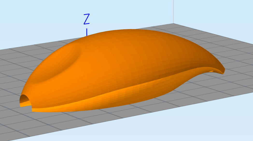

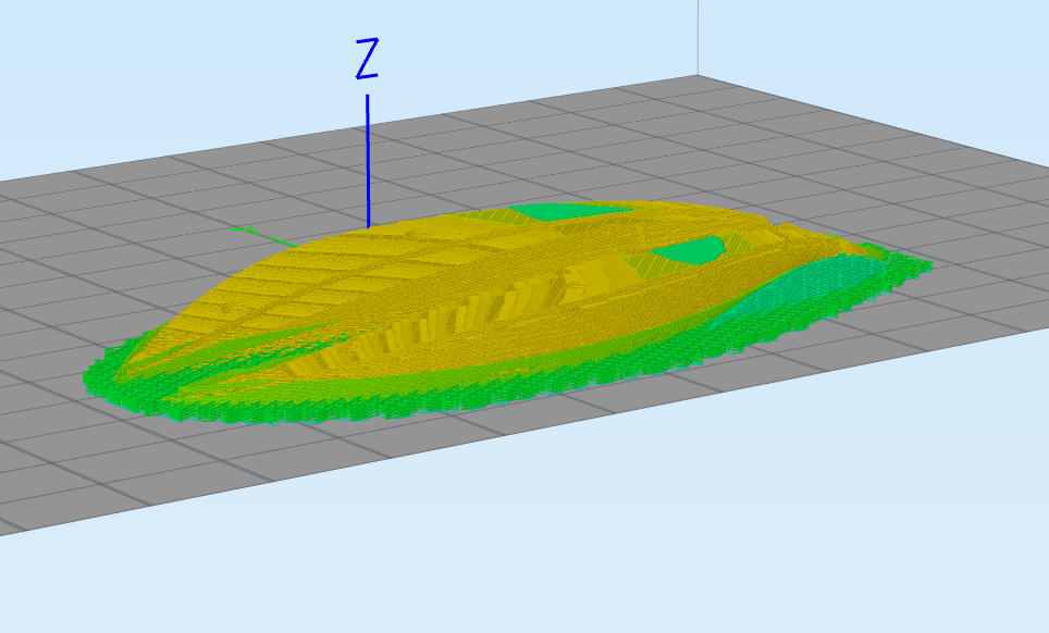

Basically I want to print a custom handle I've designed. Instead of using supports, I want to print the bottom half of the handle with the support extruder as a different process. So I'll print it with no bottom layers or shells, but more top layers. Then the top of the handle can print with the other extruder as the primary process.
Anyway, the print preview shows only the bottom being printed. I can't figure out why. Models are selected correctly for the processes and when I choose prepare I select all process. Bug? I can't seem to find a setting to fix it.

Ok, lol nevermind. Somehow my process got saved with stop printing at height checked. Oops.
