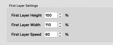

Hello,
The existing options for height and width are not enough for my usage. I have to make a dedicated process for first layer to feed more plastic.
It would be nice to add an extra option like on picture.
Thanks

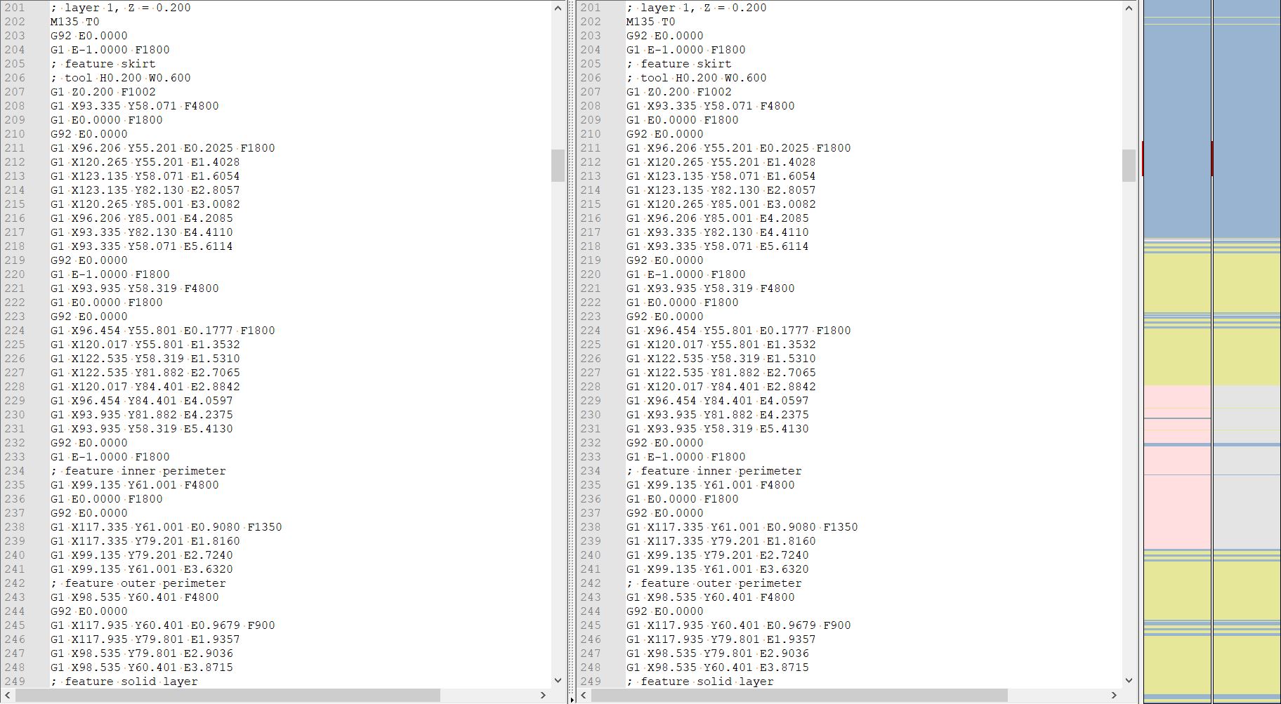

aiston wrote: ↑Sun Aug 23, 2020 7:42 pm So S3D does not push as much plastic for a 0.1 mm layer at 200% compared to a 0.2 mm layer.
Just checked this using a simple box. Layer height 0.2/1st layer 100% produces exactly the same
gcode as layer height 0.1/1st layer 200% does for perimeters/solid infill.
Only settings/comments differ until layer 2 starts...
Another thing you might want to consider if you don't want to adjust z offset might be using a
seperate process for the whole 1st layer.

by dibor
Precisely wrote: ↑Mon Mar 07, 2022 12:38 pm Yes, please add a First Layer Extrusion Multiplier setting.
Hi.
U can use this settings instead
U will get same effect.
