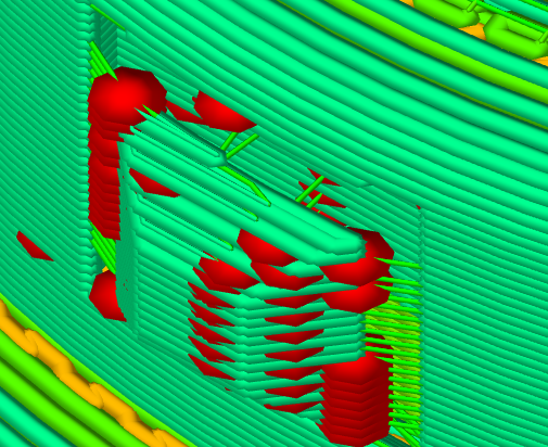

I'm trying to print a model with extruded "bump" all around the model:

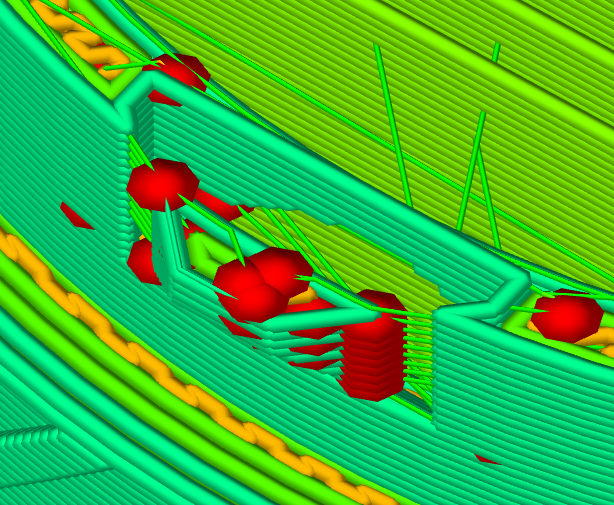

But there is a gap between my shape and the bump :

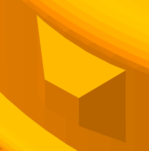

and behind the bump, the shape is empty:
Could you help me figure out the problem ? I tried to change but without any success.
Re: extruded part not merged
Use the Separate Connected Surfaces option on the Mesh menu.
