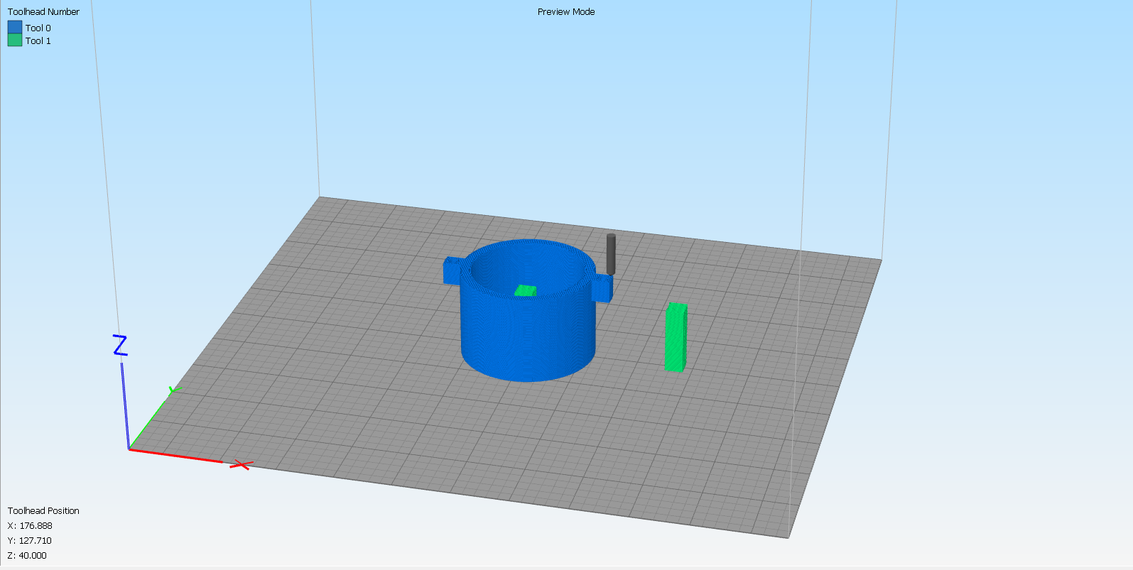

When you talk about deformation, do you mean that the support appears separate from the part? If this is the case, it is due to the Tool offset between the nozzles. It will look weird but it will print normal. The same will happen if you print only with the extruder that has the offset, in the preview the part will be seen with the offset but it will print normal.

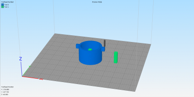

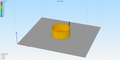

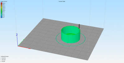

In my 3D Printer:
Right Extruder
Left Extruder
Both Extruders
If this is not what you are talking about, could you detail what is happening?
