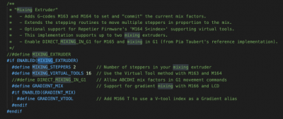

nkuck
Posts: 31
Joined: Mon May 23, 2016 2:32 pm
Re: Dual Extruder Printing Questions
That is what I had selected. See attachment.

So Marlin sounds to be setup correctly, need a bit more information to narrow the problem down for you.
