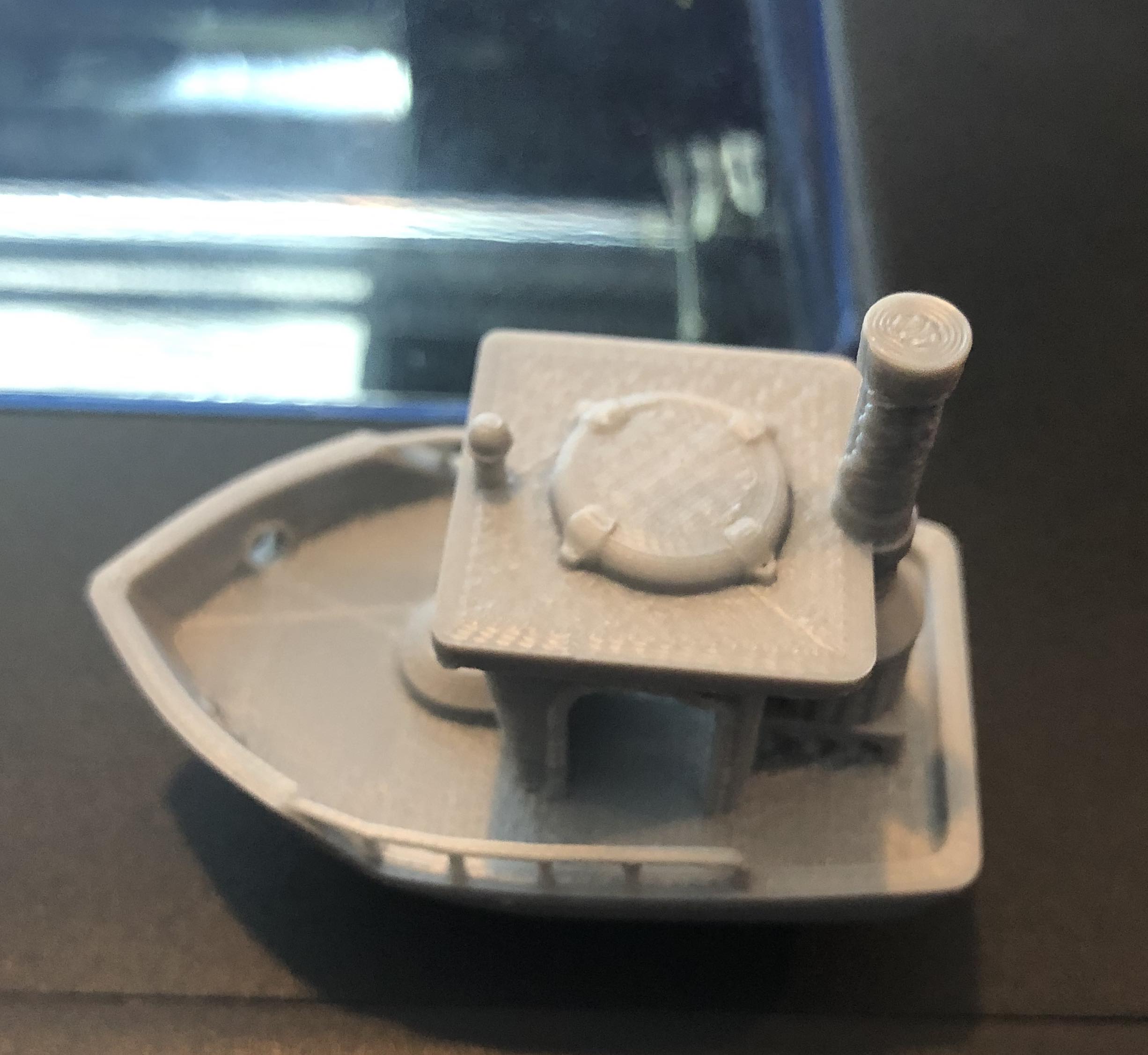

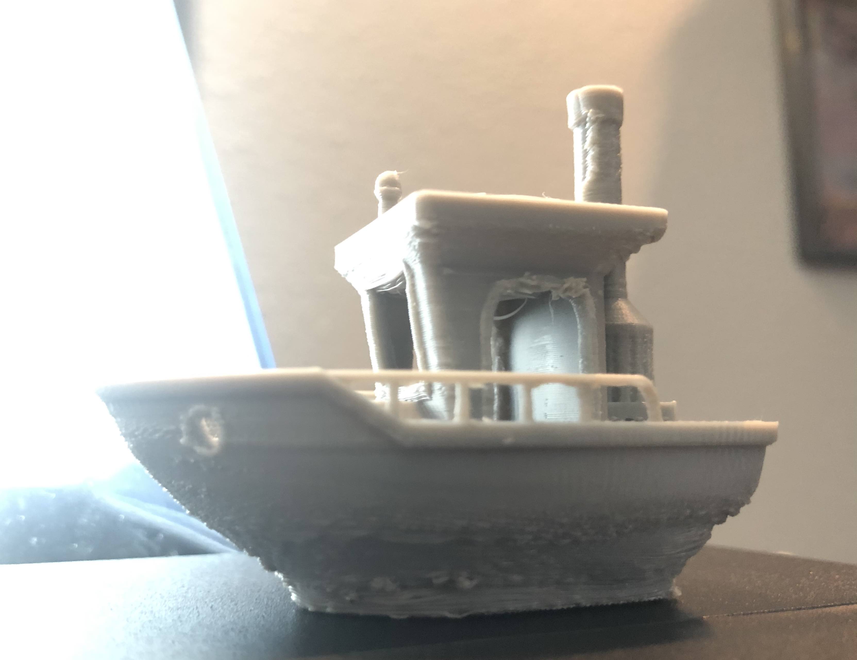

I can make it worse, but nothing I do makes it better. Overhangs 50 degrees or better warp up, then seem to push layers out in to uneven strands and gaps. If I print the file a second time, perfectly replicated distortions. I started with bone stock settings and tweaked nearly every setting I can find, one at a time.

Fixed it.
First,
The filament guide tube was colliding with the lid and pressing down on the extruder, which seems to only be an issue with overhangs.
Moving on to settings,
- Fan speed to 0 and turning off the bed at layer 5 significantly helped reduce warping to near perfect prints.
- The Simplify default value for extrusion multiplier seems to be 1.1, I dropped it to 0.9. This helped the walls not squish out, but caused pillowing, so I increased the top and bottom layers from 3 to 6.
- I was having some z-seam issues still, so I increased the retraction distance from 1.4mm to 5mm, which helped, then increased the perimeter shell from 2 to 3, which hid all z-seam distortions but brought back the original looking issues where whole layers are kicking out.
- I decreased the infill overlap from 20% to 0% which took stress off the walls, and dialed back the Infill extrusion width, which was defaulted at 125%, to 100%
