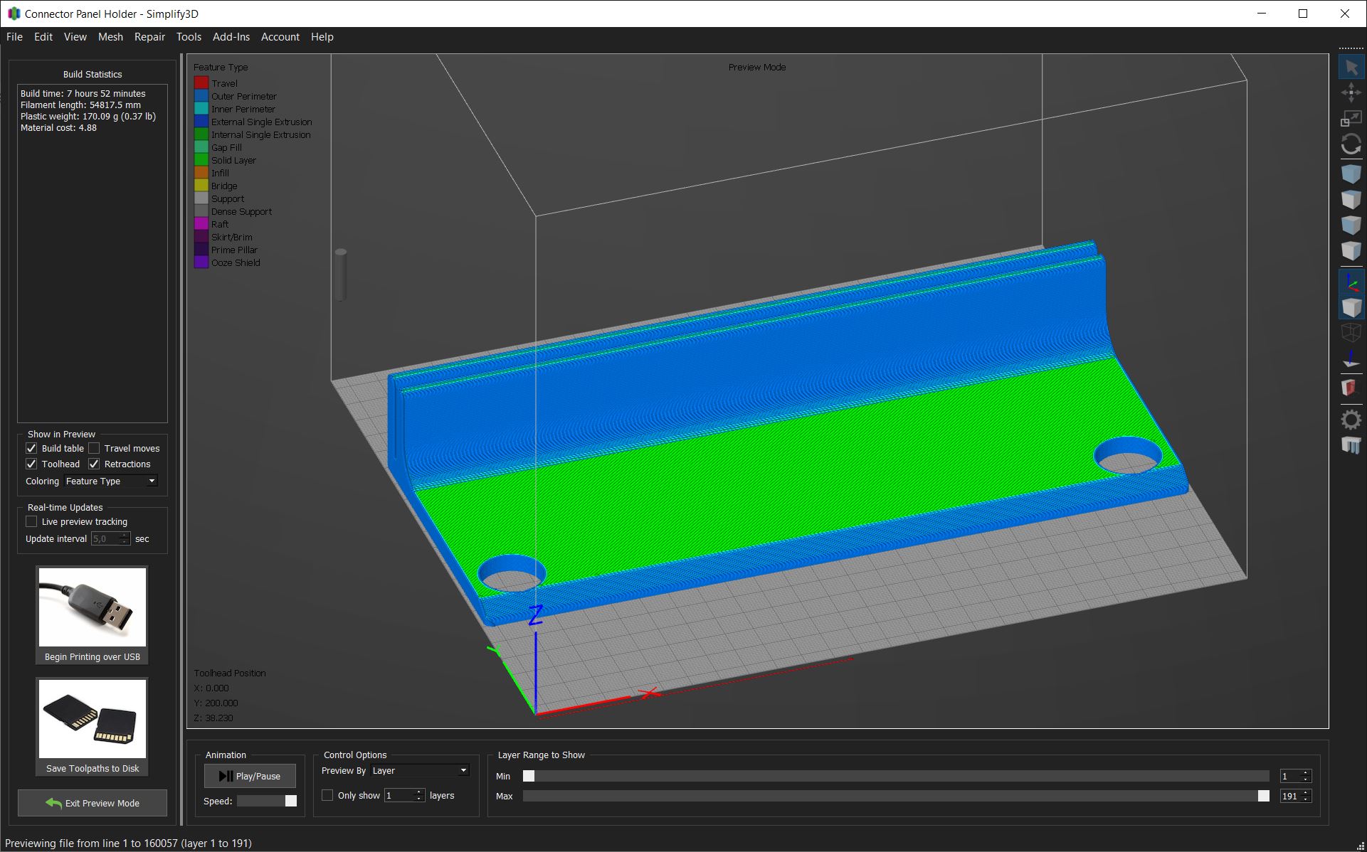

Hi all,
I am new to S3D and am having an issue with getting my model to slice. It is a relatively simple model that I created in SolidWorks and saved as an .STL file that should only need one process if I'm understanding the software correctly. I have tried resetting all settings, my start height in advanced settings is not activated, the model is not too thin, I don't think any repairs need to be made, but it will not show up in the print preview. It shows a time of 0s and size of 0KB so it isn't being sliced at all. If anyone has any ideas or solutions please let me know! I will attach the factory file and see if maybe anyone thinks the file itself is the problem.

TiagoAmorim wrote: ↑Thu Sep 10, 2020 6:22 pm I'm having the same problem and I can't solve it. Is there any way to figure this out?
You're having exactly the same problem with exactly the same stl and settings? :shock:
Models/features being ignored is caused by a faulty model very often. Maybe you'd like to add a factory file (or model file) so others can have a look at.
arabelle.force wrote: I will attach the factory file and see if maybe anyone thinks the file itself is the problem. Connector Panel Holder.factory
Sliced without problems using S3D v4.1.2...

The part sliced okay for me as well. stl file checks out...no errors.
I see no reason for the part not to slice...unless the S3D installation is corrupt.
