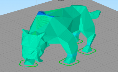

Hey everyone, I could use a bit of help with a model I purchased to print. Simplify3d is not generating supports for it.
The Model https://cults3d.com/en/3d-model/art/saber-toothed-tiger
I have a Creality CRS-10 Pro
Simplify 3D 4.1.2

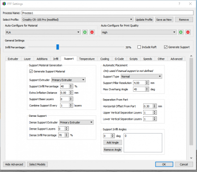

Printing on the High Quality setting with Supports, I tried default settings and also tried lowering the Support Pillar Resolution and tried 1mm and 2mm and Angle but I am not able to get any supports to show up for this model. Help please! :)

Probably worth you having a read of this:
https://www.simplify3d.com/support/arti ... tructures/
With such large flat angled surfaces underneath, it looks as if you need to create the supports manually. No quick fix, I'm afraid!...you'll need to learn how to do things for yourself.

FlashPrint handled the supports fine for it so figured S3D should be able to auto generate some. I'll keep digging around

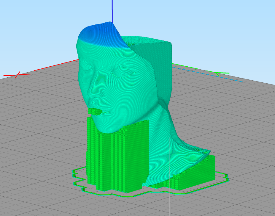

Here is the Alita Head with supports in S3D

sinabu wrote: Fri Jun 26, 2020 12:53 pm Here is the Alita Head with supports in S3D
Support generation seems to work alright here (although for that model I'd recommend supports from the build table only).
I think Doug gave this hint recently: Opening models using the 3d builder on Win10 and saving them to .3mf might fix issues, so maybe that's worth a try!
