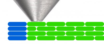

i would like to see an external fill pattern that prints lines in one linear direction per layer, but offset alternating layers so the line prints directly on top of the seam of the previous layer, so as to reduce the "air gap" between layers.
blue = perimiter / green = external fill pattern

Nice image! I'll document this request for our development team to view. We'll also keep an eye out for larger user interest.

I can see benefit there, but in the interest of part strength I'd like to see an option for two layers overlapping at 45, then two layers overlapping at -45 (or whatever angles are selected).

zemlin wrote: Thu Jul 16, 2020 5:58 pm I can see benefit there, but in the interest of part strength I'd like to see an option for two layers overlapping at 45, then two layers overlapping at -45 (or whatever angles are selected).
yeah this kinda would have gone with the idea i had in mind, as we already have an option to change rotation values by layer for both external and internal fill; but i guess 45 degrees at every 2 layers would be a good default setting for rectilinear.
however my pictured idea was also meant to include concentric fill as well, but my actual design skills are reserved for when i'm being paid to do it lol
