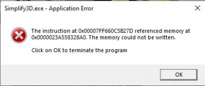

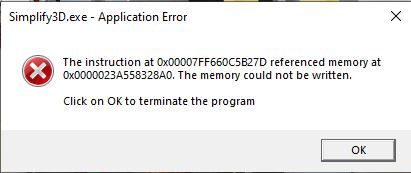

Try to open S3D and it loads 3 past .stl files and then closes. Try to open an .stl which S3D is my default .stl viewer...and this occurs..? No conditions have changed on my PC and first time seeing this in about 5yrs of use.

If there's one specific STL causing this you might solve this by deleting the saved state:
c:\users\_username_\appdata\local\simplify3d\s3d-software\savedState.factory
or
%localappdata%\simplify3d\s3d-software\savedState.factory

Deleting: c:\users\_username_\appdata\local\simplify3d\s3d-software\savedState.factory worked; Thanks
