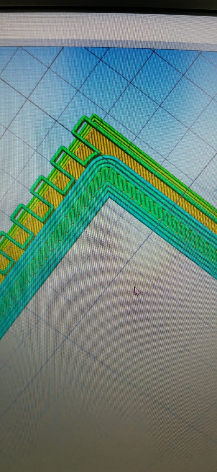

Hi there,
just bought S3D and i have 1 major issue already..
When i use support i have 2 of 4 sides that are not supporting anything.. it just makes 2 thin lines. When printing this file, the walls on that side are hanging down.

Why don't you try changing the support infill angle to 45 degrees. That will give a similar support to both the X direction sides and Y direction sides.
You could also add a single dense layer at 100%
