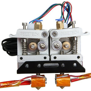

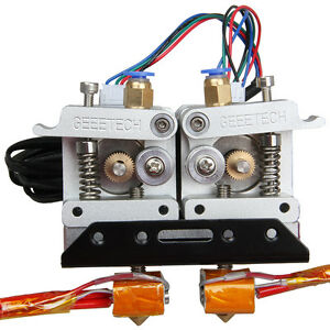

Not saying you're using one of those old extruders, just an image to illustrate this:
Left one -> clockwise, right one -> counterclockwise

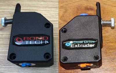

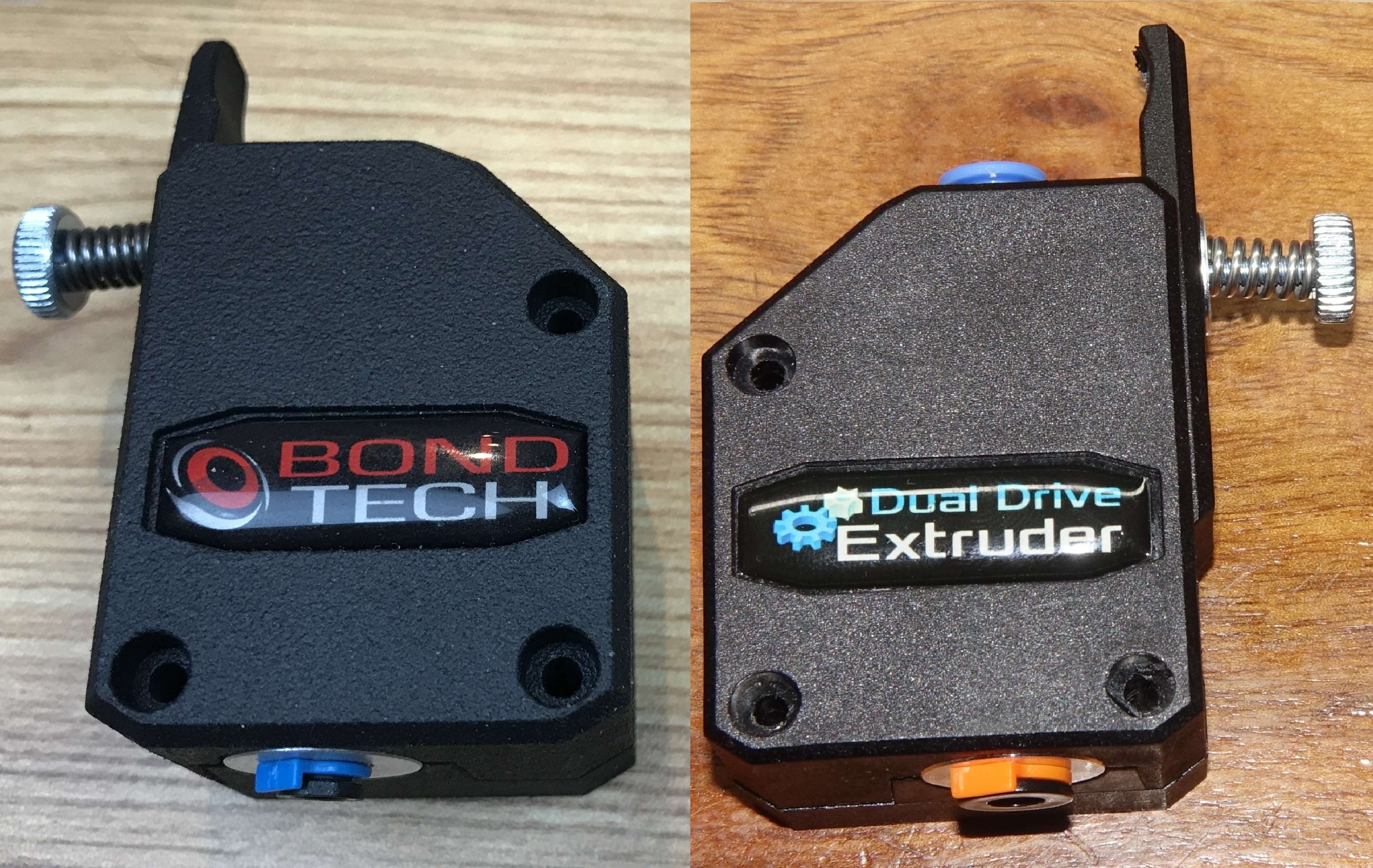

Same can be true for dual gear/drive extruders, depending on orientation/layout:
Looking at the filament path here it looks like:
Left one -> counterclockwise, right one -> clockwise
