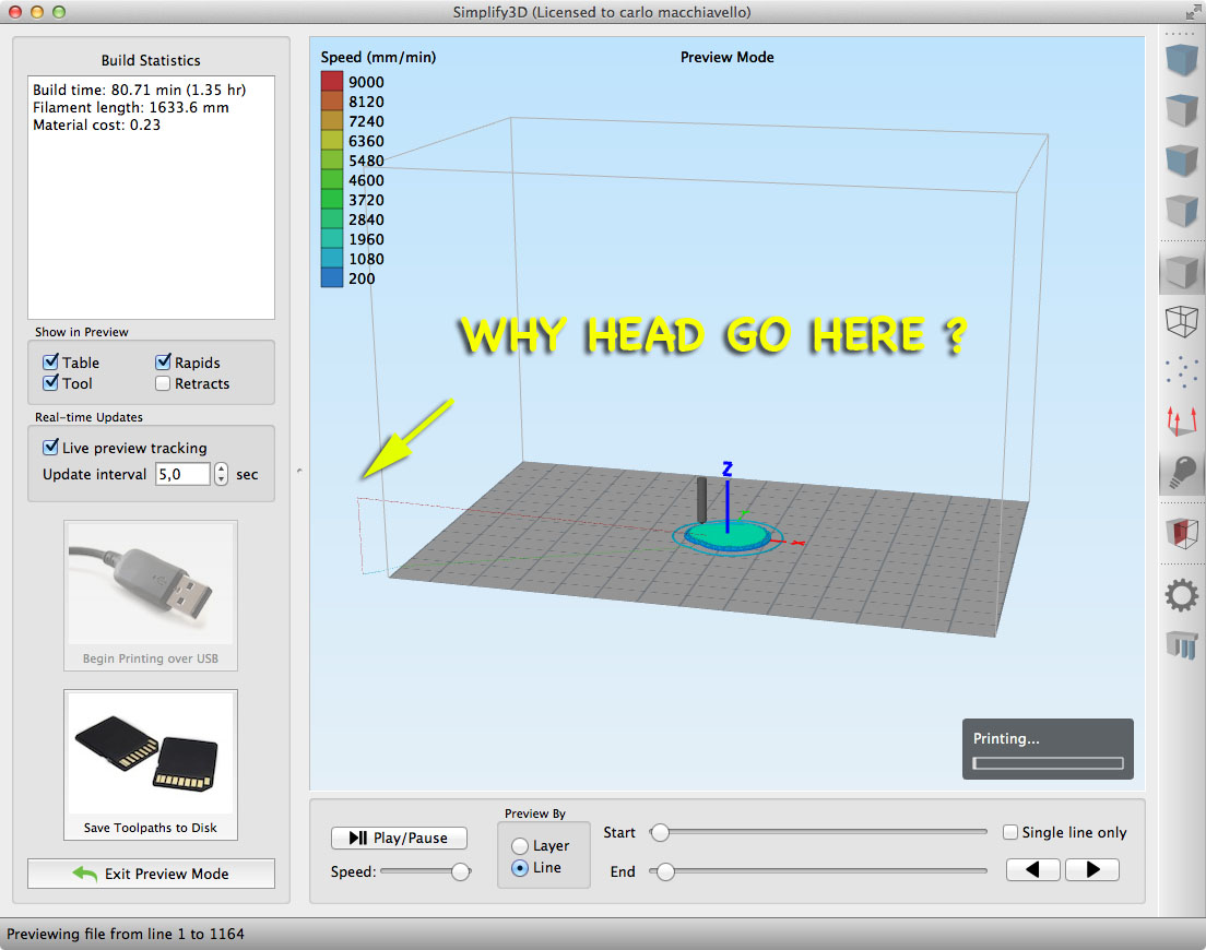

I just bought software, i tried to setup with default, but something start strange.
i use it under mac, and when printer start, it move head out of bed, and go in error.
You can see also from preview in this picture, see the arrow...
what is my error?

that should be the purge and wipe sequence but it looks like its going too far. that whole sequence is in your process settings under start gcode. adjust it to your liking. it is normall supposed to go just off the bed and purge 20mm of filament to prime the nozzle then it uses the edge of the bed to wipe off the plastic.
