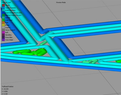

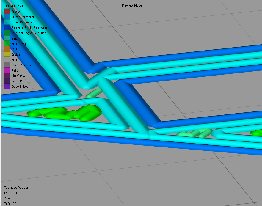

I've got a two process print. Both processes are 0.1mm. The first process stops printing at 0.11mm and the second starts at 0.10mm. I have this because my printer is crap and i need a bunch of different settings to get a good first layer.

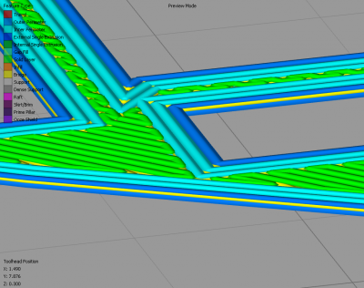

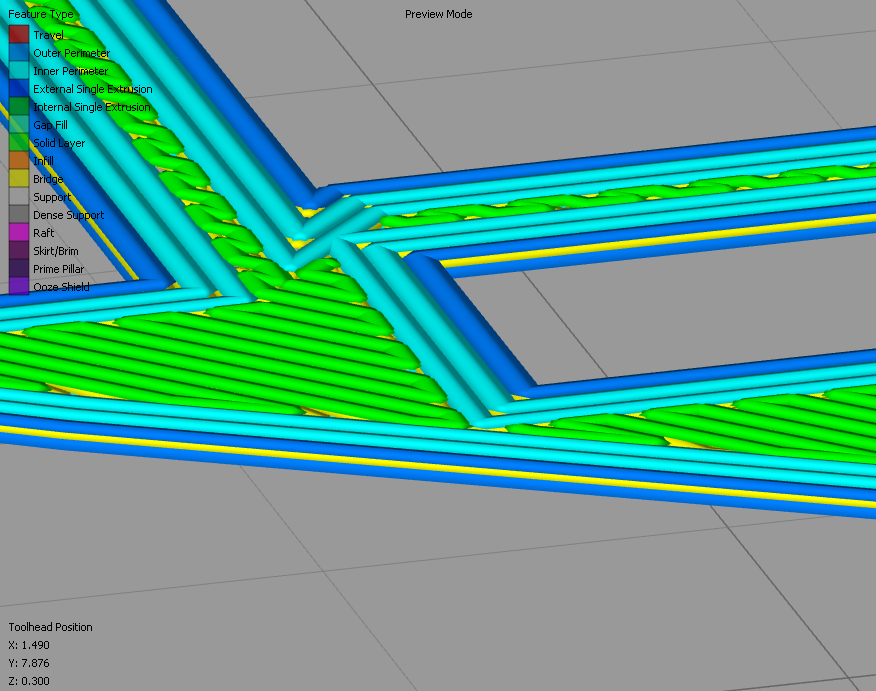

What i found though is the second layer (the first layer of the second process) is printed entirely as a bridge. Can something be done to prevent this?
First layer
Second layer
Third layer

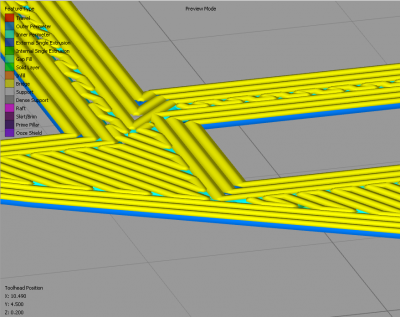

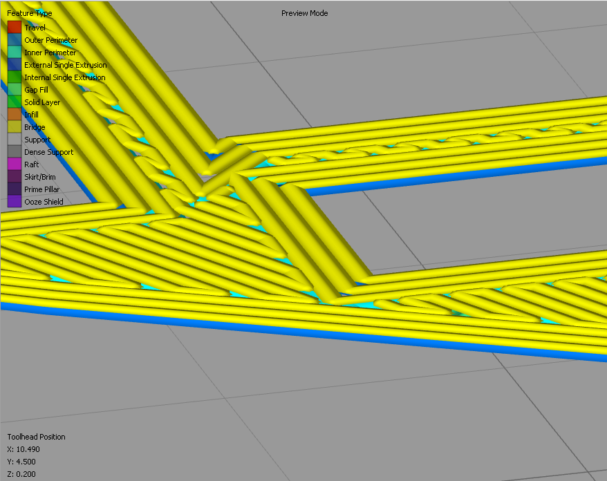

I tried to recreate this, factory file attached.
Process1, 0.1mm layer height, stops at 0.11mm
Process2, 0.1mm layer height, starts at 0.10mm
Checked this out of curiousity. I would have expected a warning that two processes interfere with each other. Seems S3D calculates
overlapping based on layer height, not exactly what's been entered in start/stop. Maybe those values should be checked too and
a warning displayed if they overlap (stop 0.11, next one start at 0.1)...
Oh, not only is the second layer completely bridged, it's also adding a 2nd layer for the skirt which is set to "1 layer".... and it doesn't
set the fan to layer 2 speed here, M106 is missing. Solid layer angles are wrong, looks like process2 ignoring some settings of p1 in this case.
Code: Select all
; process Process2
; layer 2, Z = 0.200
; feature skirt
G1 Z0.200 F480
G1 X115.118 Y90.750 F12000
Entering normal start/stop positions (0.1mm in both cases) avoids this.
