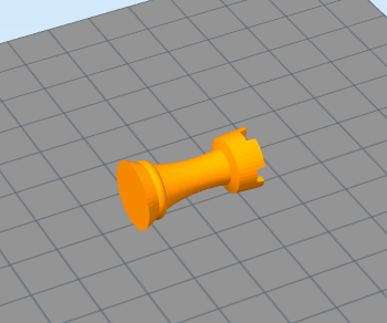

if you import a model, apply scaling/rotation, and then duplicate, it will duplicate with the alterations as well:
Original:
Screen Shot 2014-10-25 at 11.50.53 PM.png (60.94 KiB) Viewed 3923 times
Adjustments:
After duplicating with adjustments set:
