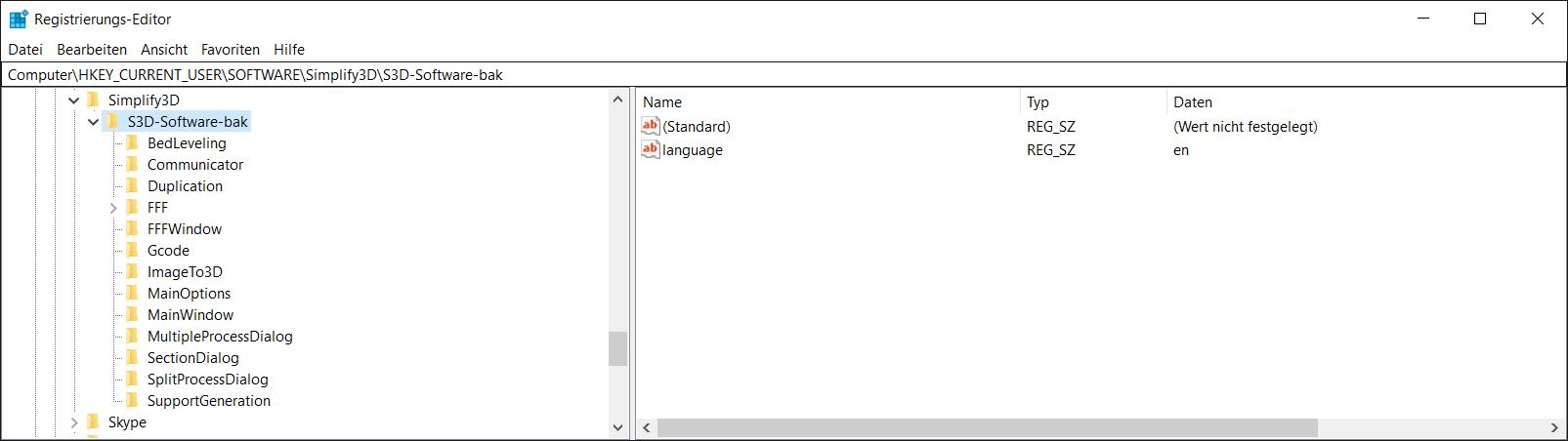

All you need to do is open regedit.exe/registry editor. Navigate to:
HKEY_CURRENT_USER\SOFTWARE\Simplify3D
There you should find another hive called "S3D-Software". Export that one (File -> Export) and rename it afterwards. S3D should do
a clean start now like it hasn't been installed before.
(The key for acceleration mode I was talking about can be found here: HKCU\SOFTWARE\Simplify3D\S3D-Software\MainOptions, in case you want to try that.)
This is what it looks like in RegEdit:

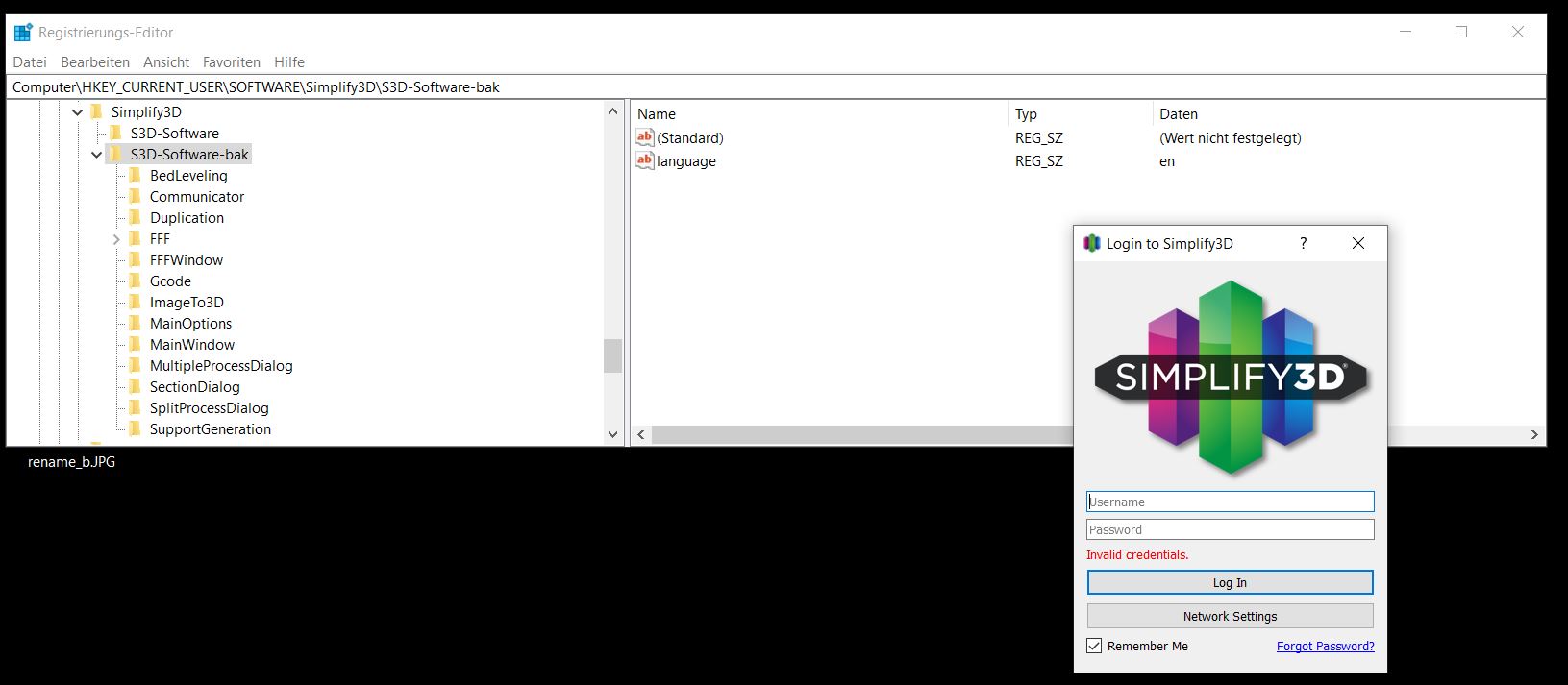

By simply renaming "S3D-Software" to "S3D-Software-bak" S3D won't be using the settings from the registry and start
like a fresh copy. This is the key renamed and S3D asking for my credentials on the next start.
If you did not see that login dialog when uninstalling/reinstalling S3D its an indicator for settings left in the registry.
(note how "S3D-Software" got recreated already inside the registry right after starting S3D)
