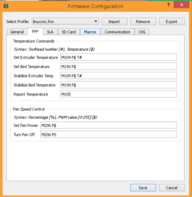

So under firmware i created my own profile for the linuxcnc by changing all the S -> P and updating values in my gcode start and end. the only post process i have to do is E -> A conversion and i wrote a simple c# script to do that. if you want the .exe let me know i can send it to ya. it takes the file name and updates it so i can tell which files i have processed.

Re: LinuxCNC gcode output request
Hey Bubbasnow,
Thanks for posting that screenshot. Our profiles look identical. Also one thing I found is that changing fan speeds or executing m codes in the middle of G really slows down linuxcnc. the M200's execute a lot faster than the 100's but it's not a huge deal. Could you post your script by chance? and which OS are you running Simplify3D? Thanks again.
