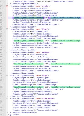

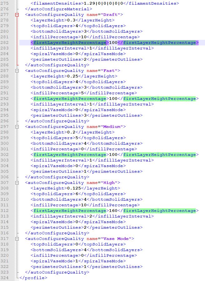

You have to include all settings you want to change within custom presets in each preset:
Another example in that picture/xml file:
Vase mode. Once selecting the preset "Vase Mode" parameter "spiralVaseMode" is set to "1". So all
the other presets need to disable/set this to 0 again.
