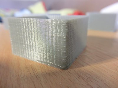

I have recently bought S3D and have been playing around with the settings trying to get perimeters to print smoothly. I've had some success by changing the extrusion multiplier and I will keep decreasing it until it starts to get worse instead of better. Also at the corners of my test print there are ''blobs''; how could I fix this?
The overall finish on the walls of the test print isn’t great and I was wondering is any of you guys can point me in the right direction to make them smoother and to get rid of the blobs.
I know that my Printer isn’t at fault because it prints it perfectly when sliced with Cura and Slic3r.
Test 1,2 and 3 from left to right and Cura to far right.
There are Blobs on the corners.

the blob is usually the start of a new layer. its what oozes out during the rapid movement. this is controlled by coasting, wipe and restart distance. you can start by maybe adding 1-2mm of coasting, turn the wipe feature on at the default 5mm. at that point do a test print. if its still a problem add a little bit of negative restart distance. start with -.10mm. keep this and coasting as low as possible to get the results you need. i would normally say the ringing you see is from high acceleration settings in your firmware or a hardware issue but with it being smooth in cura i doubt that is the issue unless in your cura or s3d starting gcode you have an mcode setting the acceleration parameters differently. might be worth looking into.

The ribbed efect can be related with infill and the overlap over the inner side walls.
Infill smashes a small portion of the wall and depending on the amount can create that look.
Using smaller overlap or even random infill start point may help.
