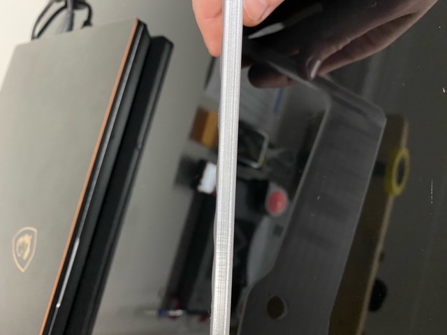

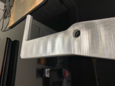

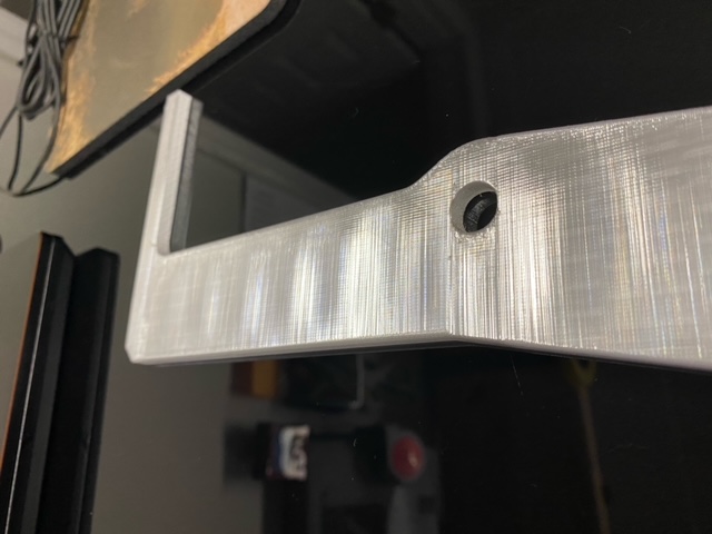

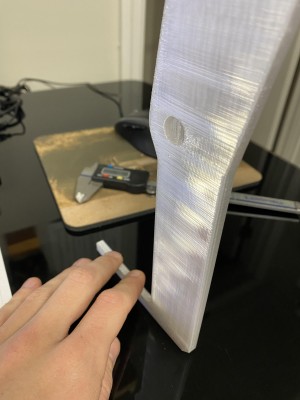

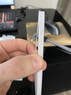

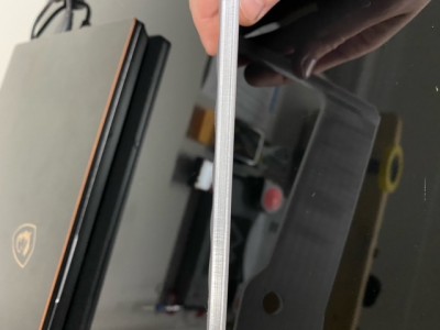

I am a recent new user and absolutely love this program. I used to use cura and after getting Simplify, I was able to get beautiful prints from my Ender 3 Pro and PETG. I have had multiple issues with what I believe to be layer adhesion. This print I did last night came out with walls that seem to be separated from the part and have "warped" into a wavy pattern(see photos). One concern I have is that its my part cooling fan. I have part cooling set to off on both Cura and Simplify3D, but everytime I print, Its turned on and spinning. I am curious if by default, the fan is supposed to run at low RPMs or if my Printer has a wire/circuit issue in the SKR Mini E3 v1.2 board. I was curious if anyone has good Ideas for getting rid of these bubbles and achieve shell wall adhesion. My settings are below. Thanks for any support!
My settings:
  • Nozzle Dia:0.4mm
  • Extru Multi:0.9
  • Lay Height:0.2mm
  • Infill & %: Rectilinear 20%
  • Bed Temp: 80 C
  • Extruder Temp: 245 C
  • Cooling: Layer 1, Fan Speed 0
  • Print Speed: 24 mm/s
  • Shell: 2 Layer outline, inside-out
Note the wave shell walls. These warped bumps are squishy and seem to be separated from the part.

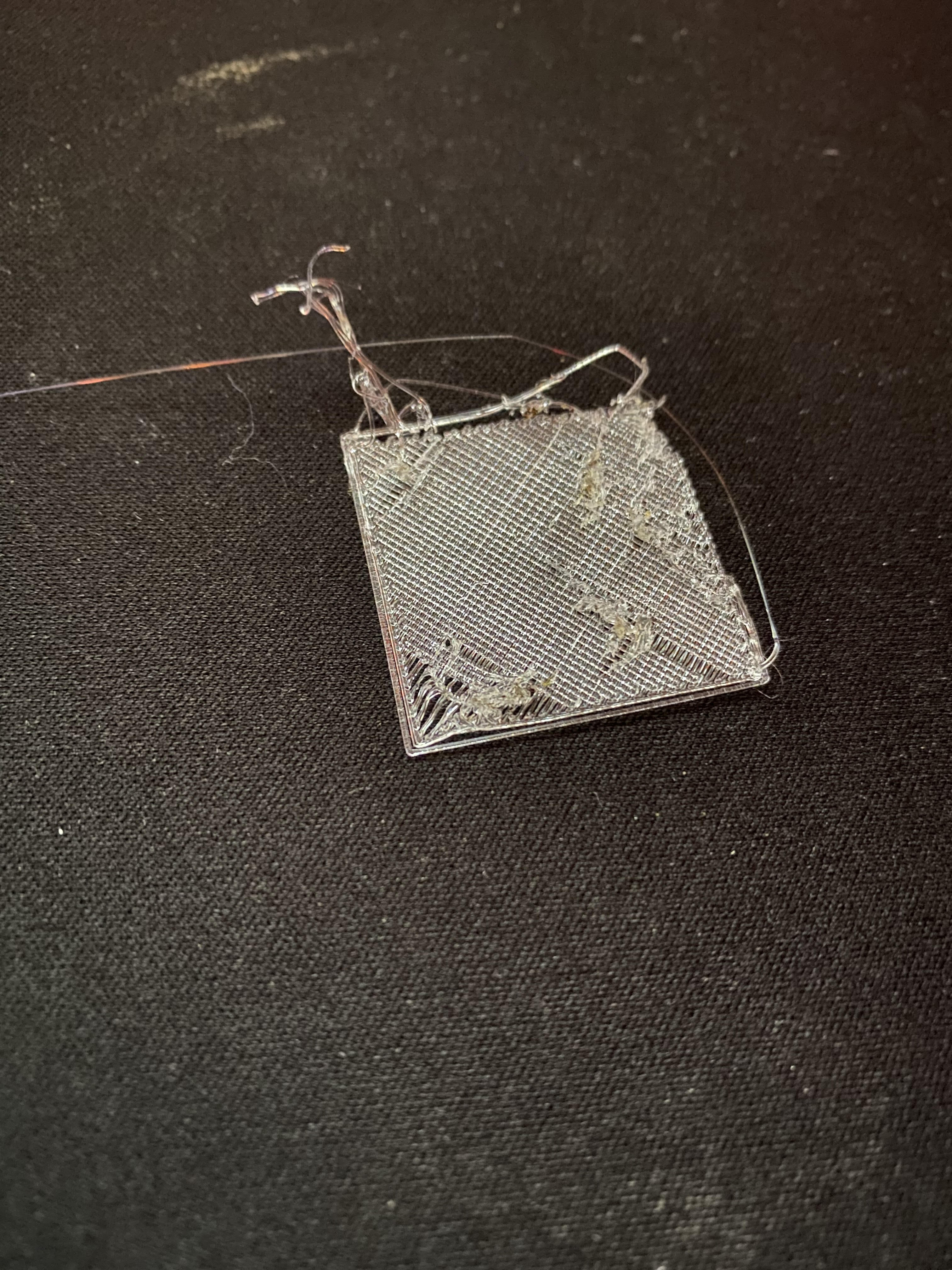

Use the attached model to verify your extrusion multiplier, there should be no gaps between the stands of plastic (Use a jeweler loop or USB microscope)
You may want to try a but lower temp, I use 235 for PETG but do not have the same printer
Waves may be lack of infil... hard to tell from you picture . You can attach a factory file File > facoryfile > save as which will let folks help you better
2 layers at .2 x 30x30.stl
(684 Bytes) Downloaded 465 times

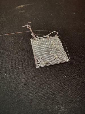

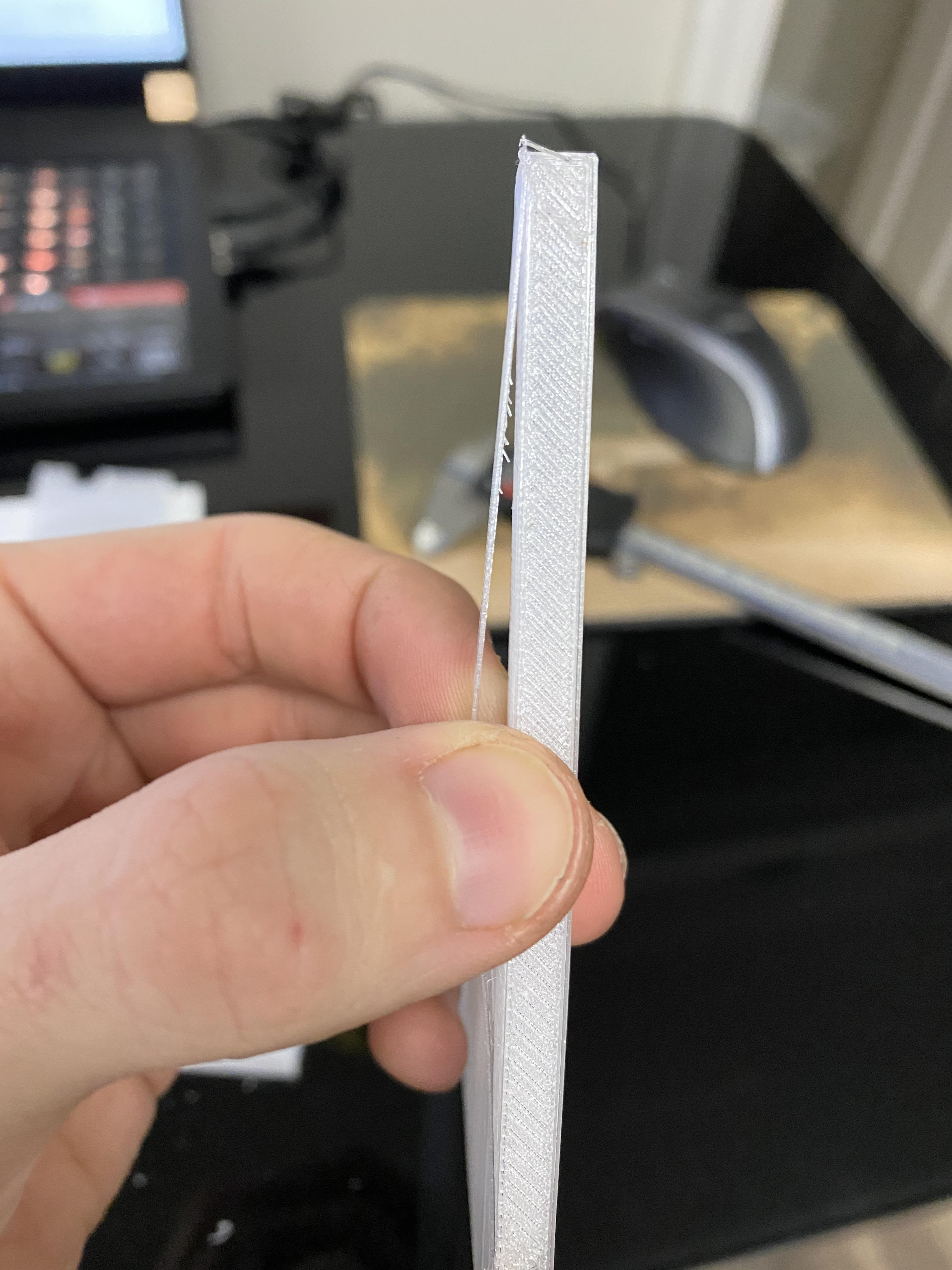

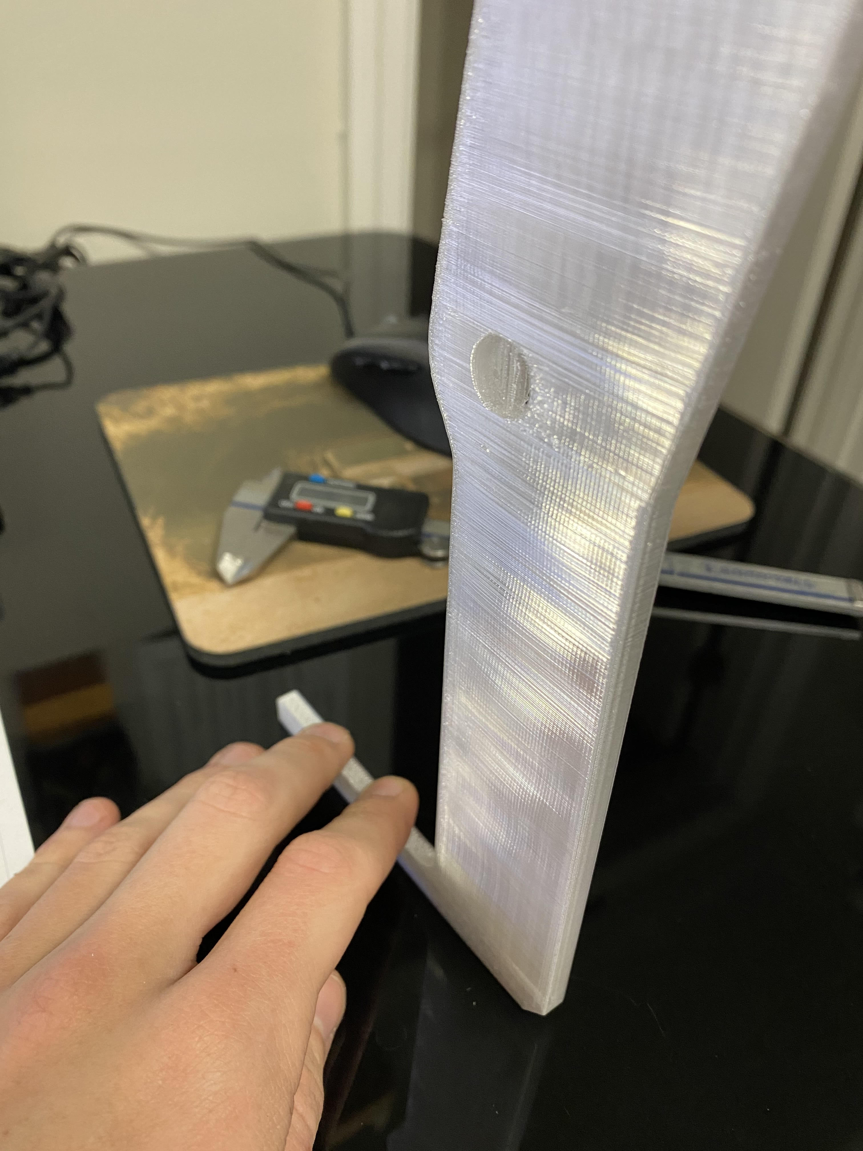

Awesome I will try this print tonight and save/post the facory file. I was able to fix my fan. I printed it without the part cooling fan on and had the same results. Additionally I want to note that the print is vertical not flat(as shown in the photo attached). Thanks for the help!

I did test print and attached my facory file. It looks like I am under extruding after looking at this test print. I am going to try bumping up my extrusion multiplier and see what happens. Thanks.

I raised my extrusion multiplier to 1.05 and still getting weak squishy prints.

Who's PETG filament are you running? I generally run PETG hotter - makes for stronger parts, but not all PETG does well hotter. I've never experienced loose layers like you're seeing. Can you post a factory file?

I have had this issue. My solution was to dry out the filament. Even though PETG does not absorb moister the same way nylon or abs does, it will.
After drying most of the problems go away and you get a smooth print. Also make sure that you are running high enough heat on the hot-end. When i print with PetG i print at 255c. Bed temp is 87c...
Another point is the retractions .....do not use fast speeds during retraction as this will not pull the soft fillament back but will instead leave a molten blob in the nozzle which will string all over the place...instead slow down the retract so that it has time to pull back the blob of molten plastic
