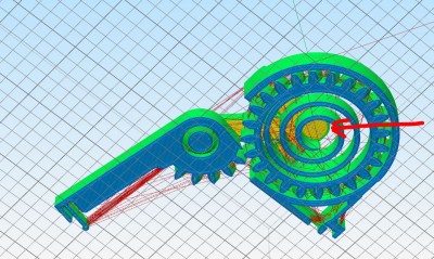

Hi, I'm trying to print a part with a fairly complex geometry (cogs, etc) and after slicing, the center of the spring is missing (red arrow on the screenshot). Any idea what could be causing that?

Its got something to do with the wall thickness. Slicing at .02 extrusion width gives a little more...and you can get single wall thin extrusion to show......but the issue is definitely with the model.
3D Builder on Win10 doesn't help.

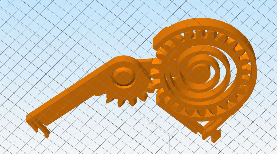

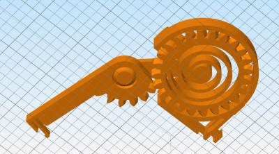

I've just stumbled on a magic fix for you......
Mesh dropdown menu.....click on Separate Connected Surfaces.
And I think that's it!! You should now get a good slice.....

It worked! Thanks Doug!
