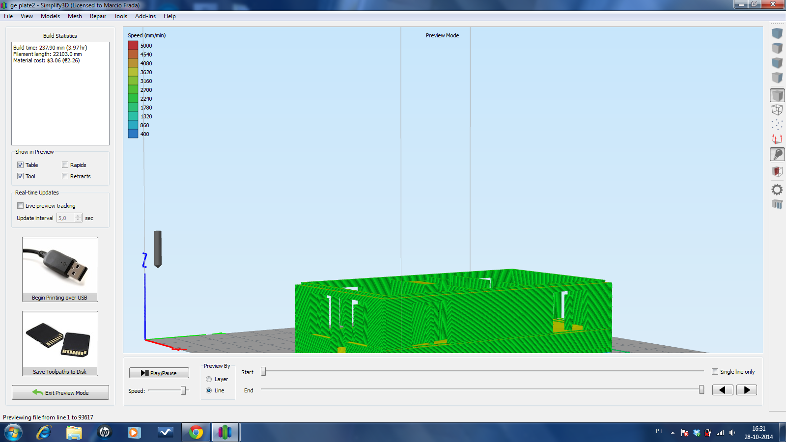

Hi guys .When i try to print this model :
http://www.thingiverse.com/thing:337914/#files
the file i have trouble is " morganhousebottom .stl"
Can someone experiment if the same isuue ocurs or better yet help me solve the problem ??
Thanks.

The STL has a few problems. I ran it through Netfabb Basic (a free program every person with 3D printer should have) and it seemed to slice OK after that though you don't mention what the problem was and I can't tell from the photo.
morganshousebottom (repaired).stl
(141.39 KiB) Downloaded 163 times
