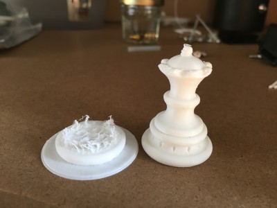

However, here are the few things I have been able to notice (see pictures) :
- the nozzle looks clogged, I can't push the filament manually after it stopped extruding and there are some debris inside
- I can see some debris inside the nozzle but the debris isn't obstructing the hole, it sits on the perimeter. I cleaned it up anyway and the ABS residue looks "cooked"
- filament in the extrudor has hollowed, just like it has coated the ptfe tube (I tried to take a picture with the light revealing the hole by passing through it). I don't know how to explain it
- the printing temperature doesn't looks too low, because the filament flows easily, everything is going right in the beginning. Considering the top of the first model I printed, I would rather think my temperature is a little bit too high than too low.

Re: White filament stops extruding mid-print
What temperatures are you printing at? If the version of your Creator Pro has PTFE lined hotends you wont want to be printing above the melting point for PTFE. Typically we don't recommend exceeding 240 in that type of setup.
Are you using the stock ABS settings in Simplify3D?
Have you reached out to our customer support team? (https://www.simplify3d.com/contact)
