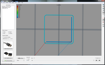

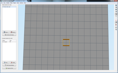

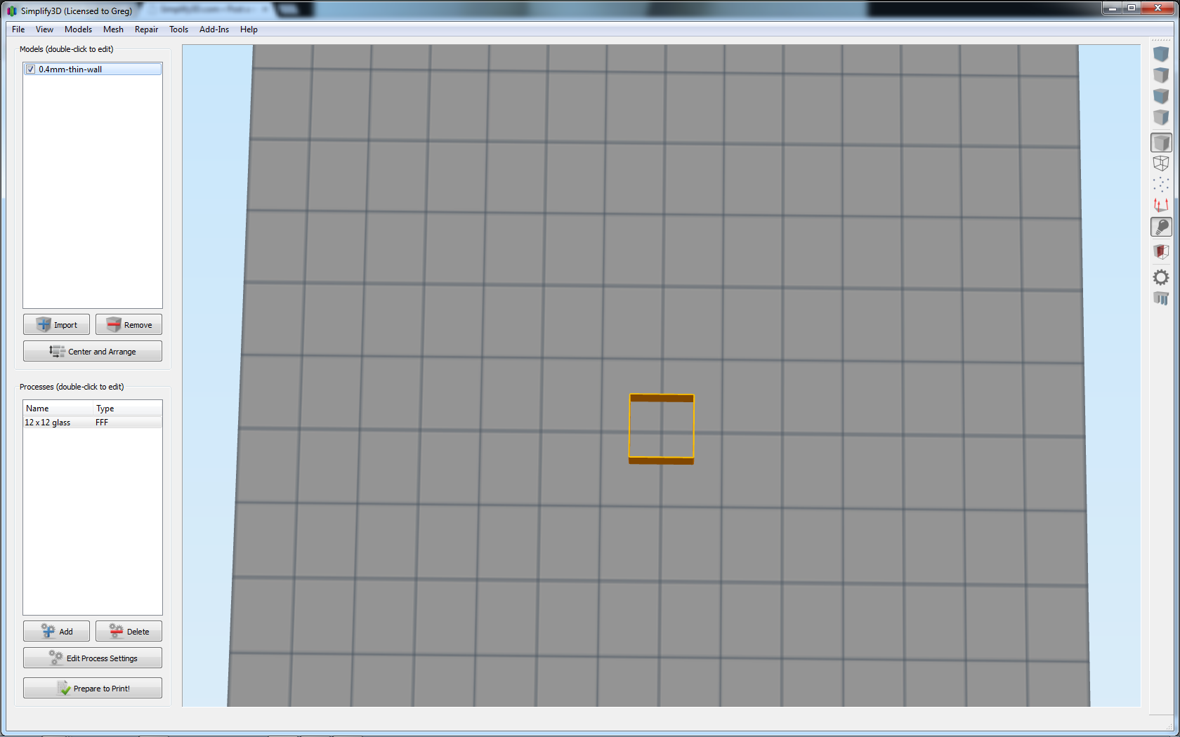

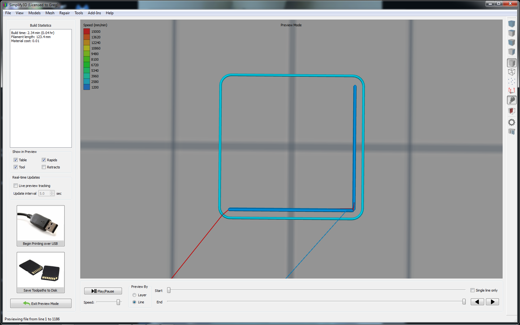

When I try to slice a .4mm thin wall cube S3D will shows half the cube and leave the other. I have tried different settings with infill and layer but all show the problem. See attached pictures

what is your extrusion width? is the width higher than .4. if any part of the model is smaller than your extrusion width it will not print it.

its a model issue....sort of. the person who made the thin wall test probably did make it at .4mm wall but what probably happened is your have s3d set to exactly .4 and perhaps when this was modeled the tolerance in the cad software wasnt high enough or when exporting the mesh it just wasnt quite on the money or high enough poly. in any case if you take your settings and make your extrusion width .38 it will slice fine. another issue i see with the thin wall model is the inside is a sharp corner box and the outer is rounded. now the corners arent .4mm at all. that will cause an issue as well. you have to remember that with your width set to the exact same # as your wall thickness you can easily run into problems and it all comes down to tolerance and math. if the model ends up having a wall thickness of .39999999999 after its made into an mesh, even though you specified a .4 then its not going to slice. even though we all know that you could never measure such a width and and we realistically still call that .4mm. point is the math is just enough for it not to work and it shows as a complete fail in the slice. to make things so they always work just keep your extrusion width 1 less that the width of the thinnest wall you are going to slice. also with simple test objects like this you are better off making them yourself with a high tolerance so you know they are right. thingiverse is loaded with bad models. with that said though, s3d should probably not be so finicky and work something in where it can just ignore certain things like that and just slice it.
