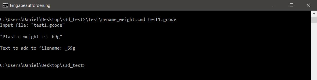

Here's what it will do/output:
"test1.gcode" is renamed to "test1_69g.gcode".

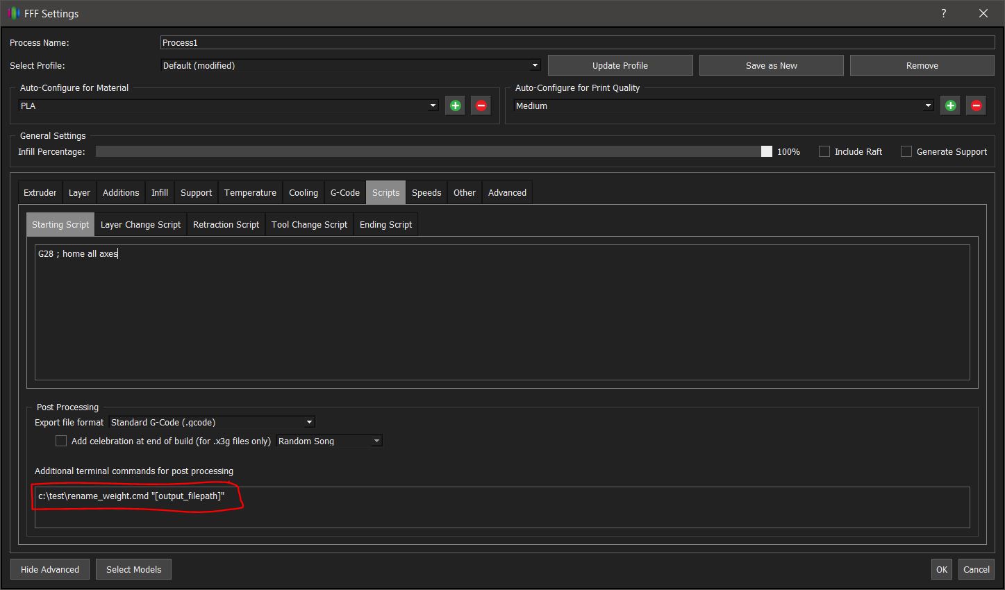

You can include this as mentioned inside S3D so it will run automatically for each gcode file you export using that profile:
