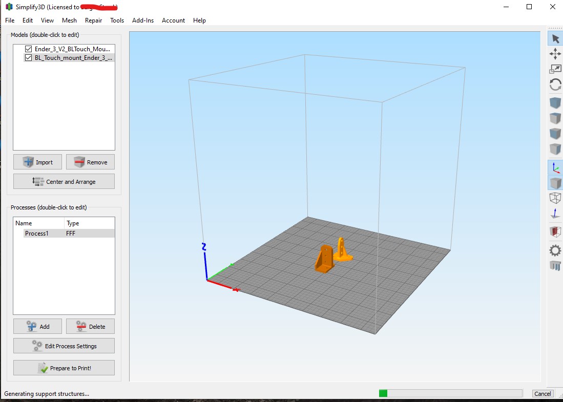

Hello,
My Simplify v.4.1.2 is freezing when I trie to "Prepare to Print!"
It is stopping at the bar and does not load. I have to close the program and open it several times until it slices and sometimes it crashes when I'm going to save the Gcode I'm forced to close and open it again.
He keeps thinking and doesn't get out of that "Generating support structures..." or on the finish "Finished parsing G-Code file" bar
I've even tried to uninstall and install the program again and even so it still has this error.

Dos someone know how to make a clean step up? Every time I trie to unistal and install all configs are back.

I trie diferents (alot) stl files and same.
Just now I trie to use other profile and test, same think, sometimes frozen when "slicing 3D models" sometimes on save gcode...
The program don't frozen, I can turn the work pice, edit process settings, etc. But the bar "loading" is frozen. I can't even click cancel.
