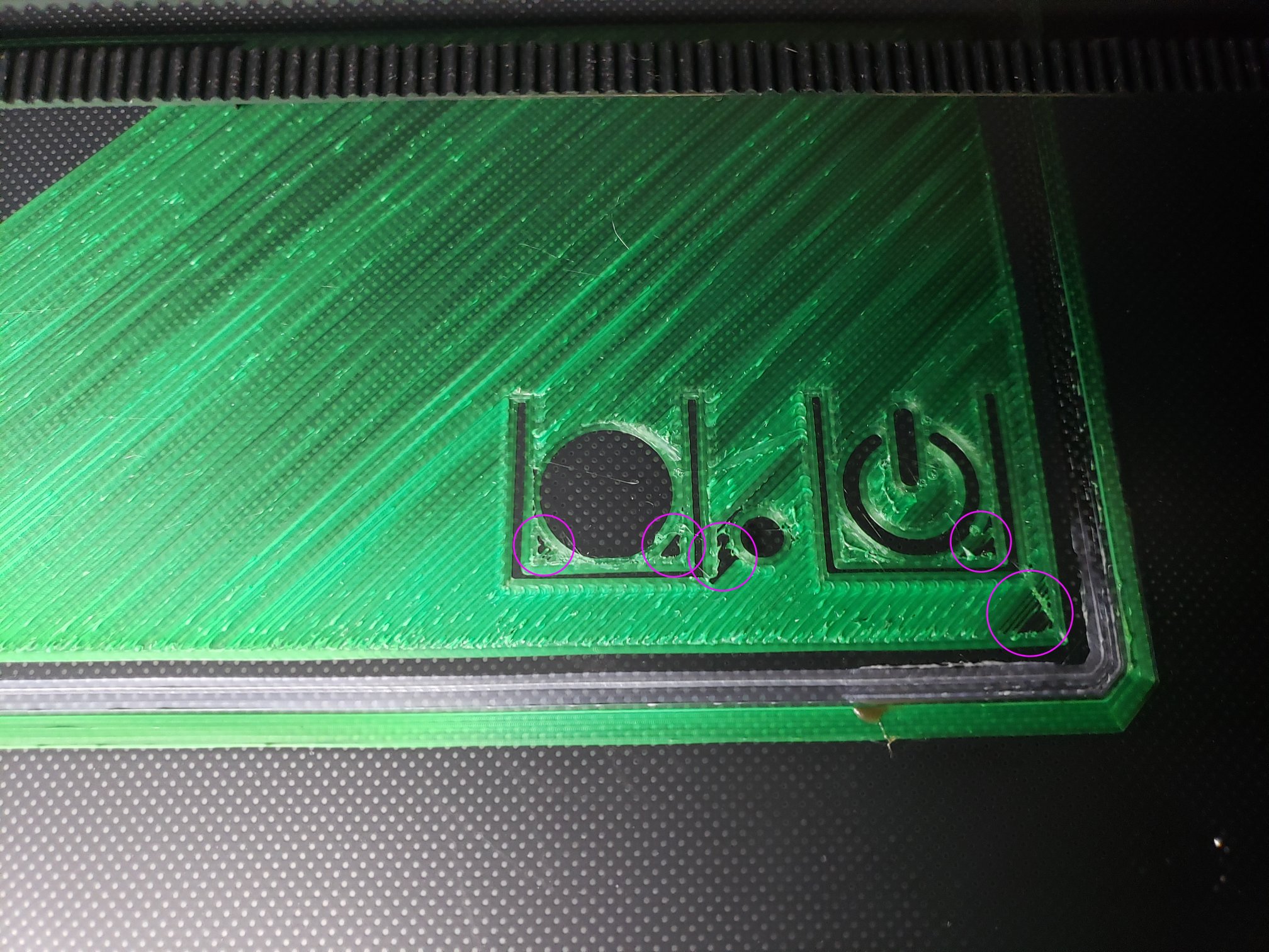

My latest issue is filament 'missing' from the corners of the first layer (picture attached). I've also (after this picture was taken) reduced the Extrusion Multiplier a bit (you can see the blobs in the pic as well).
Does anyone know why this is happening? This is PLA filament, the extruder is at 220°C, and the heated bed is at 70°C.
The purple circled areas are what I am talking about:

Have you let the print continue? Does it continue to have issues where the infill is meeting the perimeter? https://www.simplify3d.com/support/prin ... d-outline/
If it's only on the first layer, this can help you with perfecting your first layer on this new printer. https://www.simplify3d.com/support/arti ... rst-layer/
The T-Rex2 has a retraction length of 1mm and retraction speed of 1800. These are some settings I would look at fine tuning after you get your first layer dialed in.

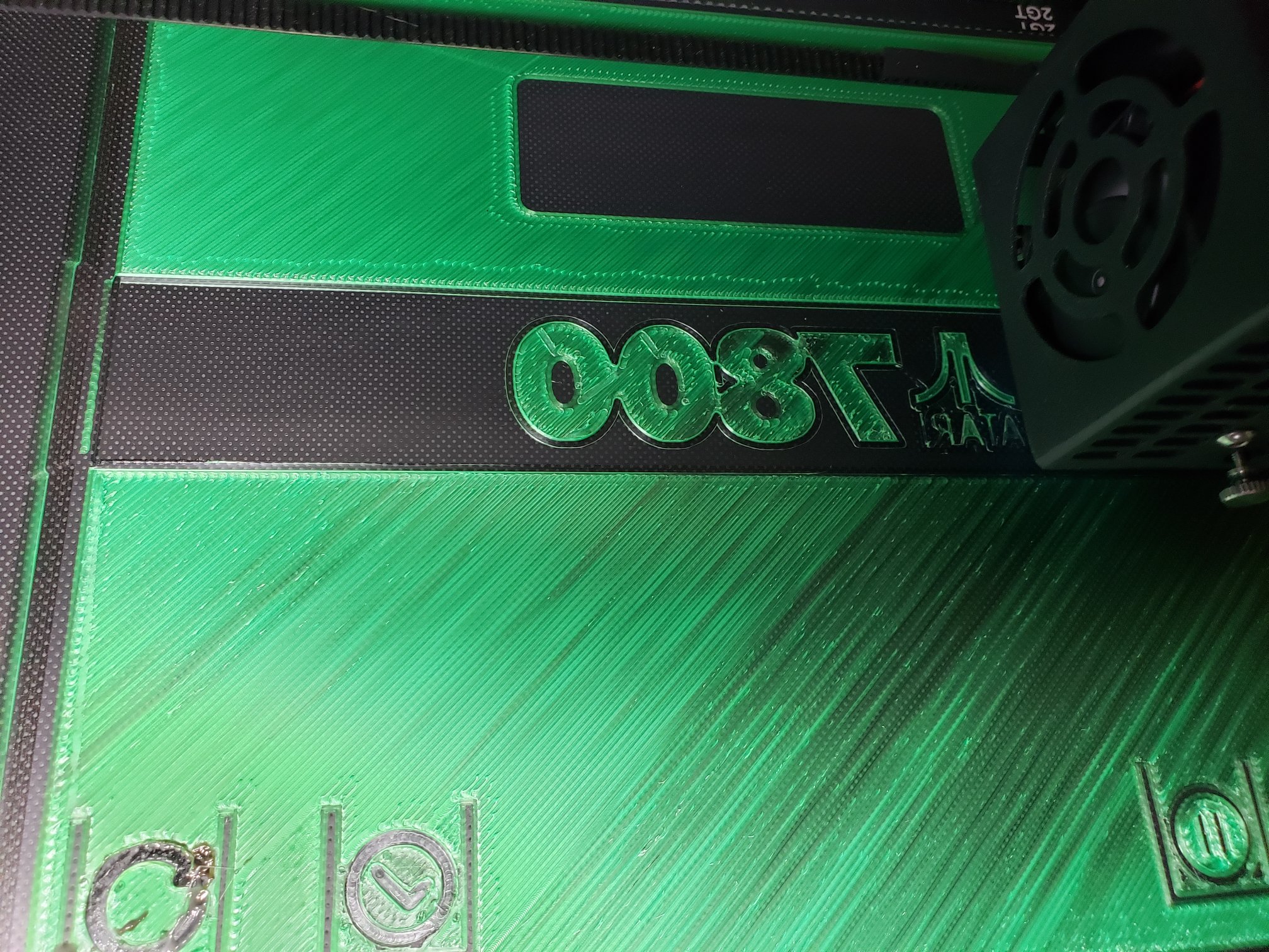

What's funny, is that the top of the print (still the first layer) looks great:
You can see where the original picture was taken in the lower-right corner.
It's a two color print, and the part that is currently blank will be silver.

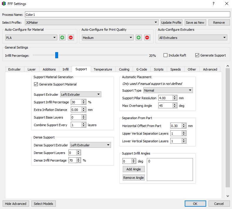

Here are my settings:

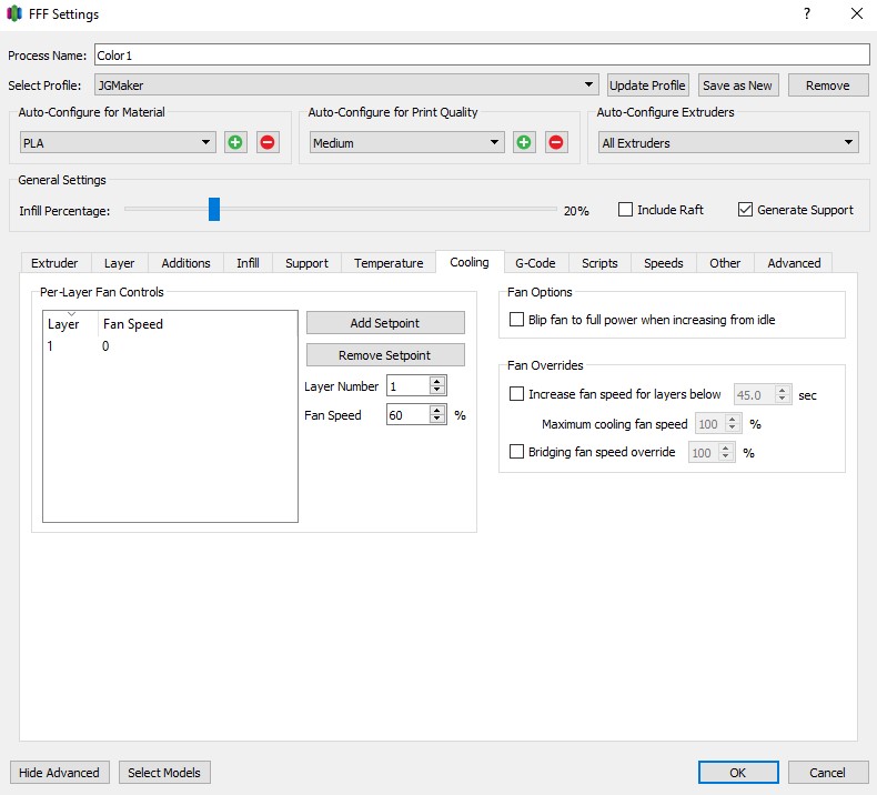

More screen shots:

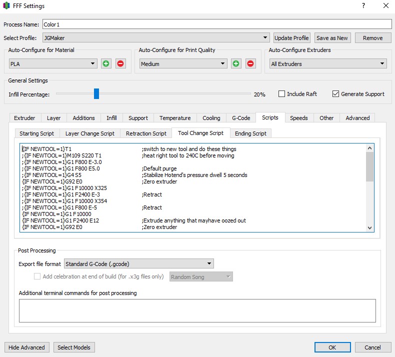

More screen shots:

With a bed that out of alignment my first bet would always be to replace the bed. Otherwise you're going to keep having issues with areas near the middle being too squished and areas near the edges being more how you want them to be. Or if you level it according to the very middle, you'll have the middle how you want it to look and then the closer you get to the edges the more likely your parts are to become too spaced out or not adhere properly at all.
15mm retractions at 1800 mm/min is going to cause the toolhead to be stationary during a standard retraction for quite a while. This can lead to blobs being deposited onto your part while the extruder is hovering there. Have you not seen issues with this?
Just to make things easier for others to come here an offer their advise you may want to upload your FFF profile rather than screenshots of every tab from the edit settings window.
