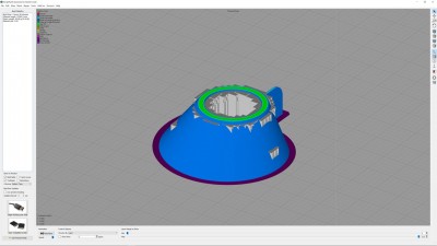

How do you keep the supports from passing through the part? See attachment.

dmc456 wrote: ↑Tue Aug 03, 2021 4:11 pm How do you keep the supports from passing through the part? See attachment.
My bet is you have support expansion distance turned on and it isn't needed. Post the model or the factory file.

or use smaller support grid. 4mm never works for me. use the 1mm.
another hack I have found is scale to 200% add 1mm supports then scale down to 50%
the support will scale with the model! think this is a bug. then the support are 0.5mm
