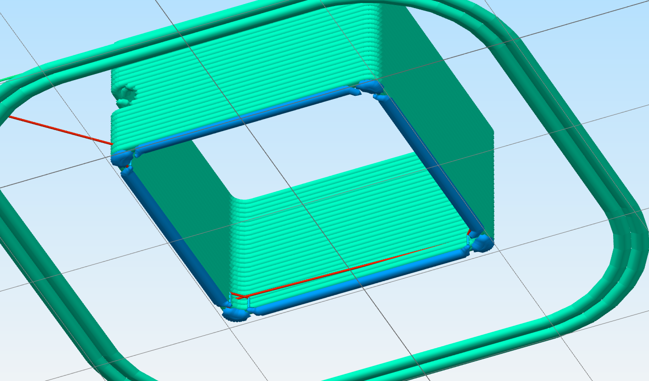

here is how it looks with external thin walls settings set to perimeters only.
here it is the way its in the factory file.
why is it printing the legs?

(Layer > First Layer Width %) First layer width is set to 150%.
(Advanced > Allowed Perimeter Overlap) Allowed perimeter overlap is set to 100%.
The combination of these two settings is allowing for the first layer to be printed as 4 separate single extrusions rather than overlapped perimeters. Set first layer width % to 100% and the first layer will mirror the following layers.

S3D-Jake wrote: Thu Aug 05, 2021 1:57 pm (Layer > First Layer Width %) First layer width is set to 150%.
Thank you!
