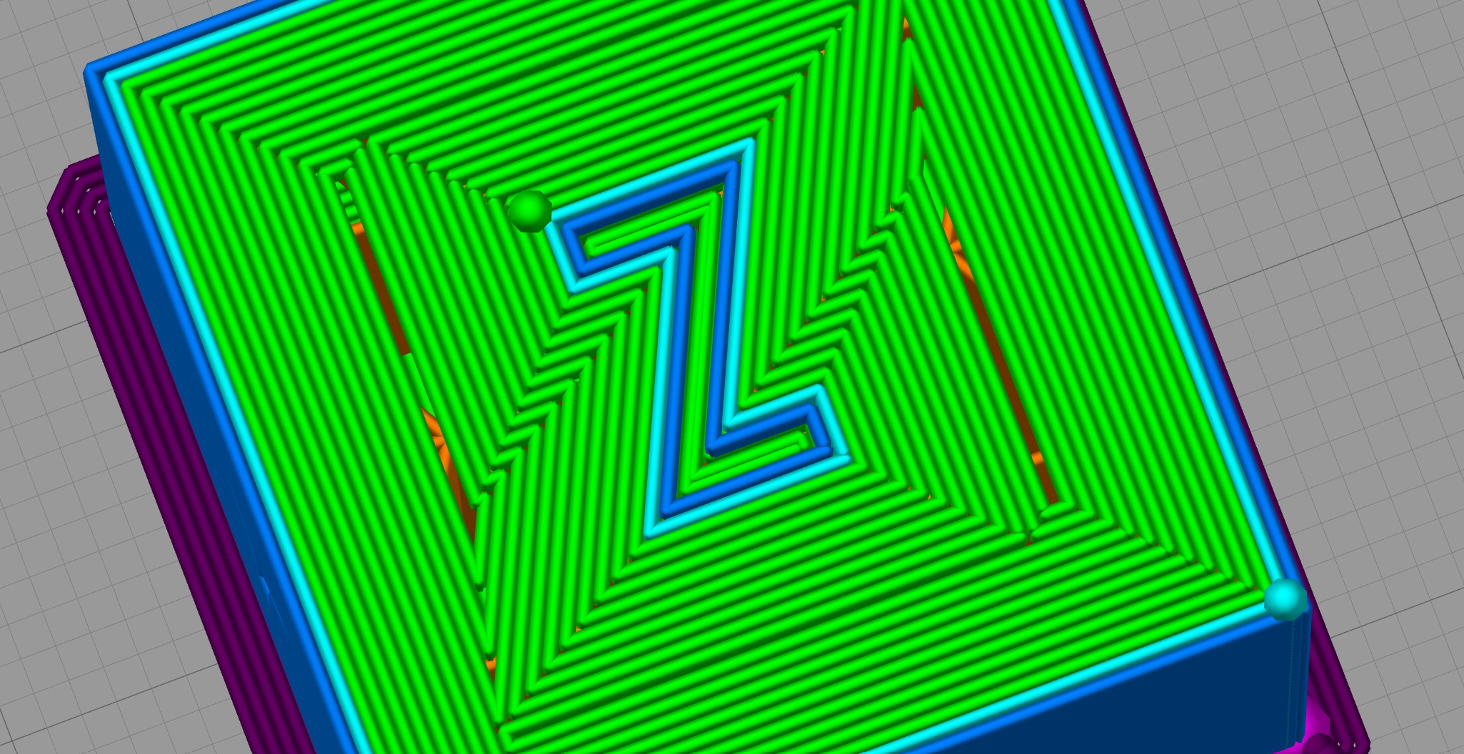

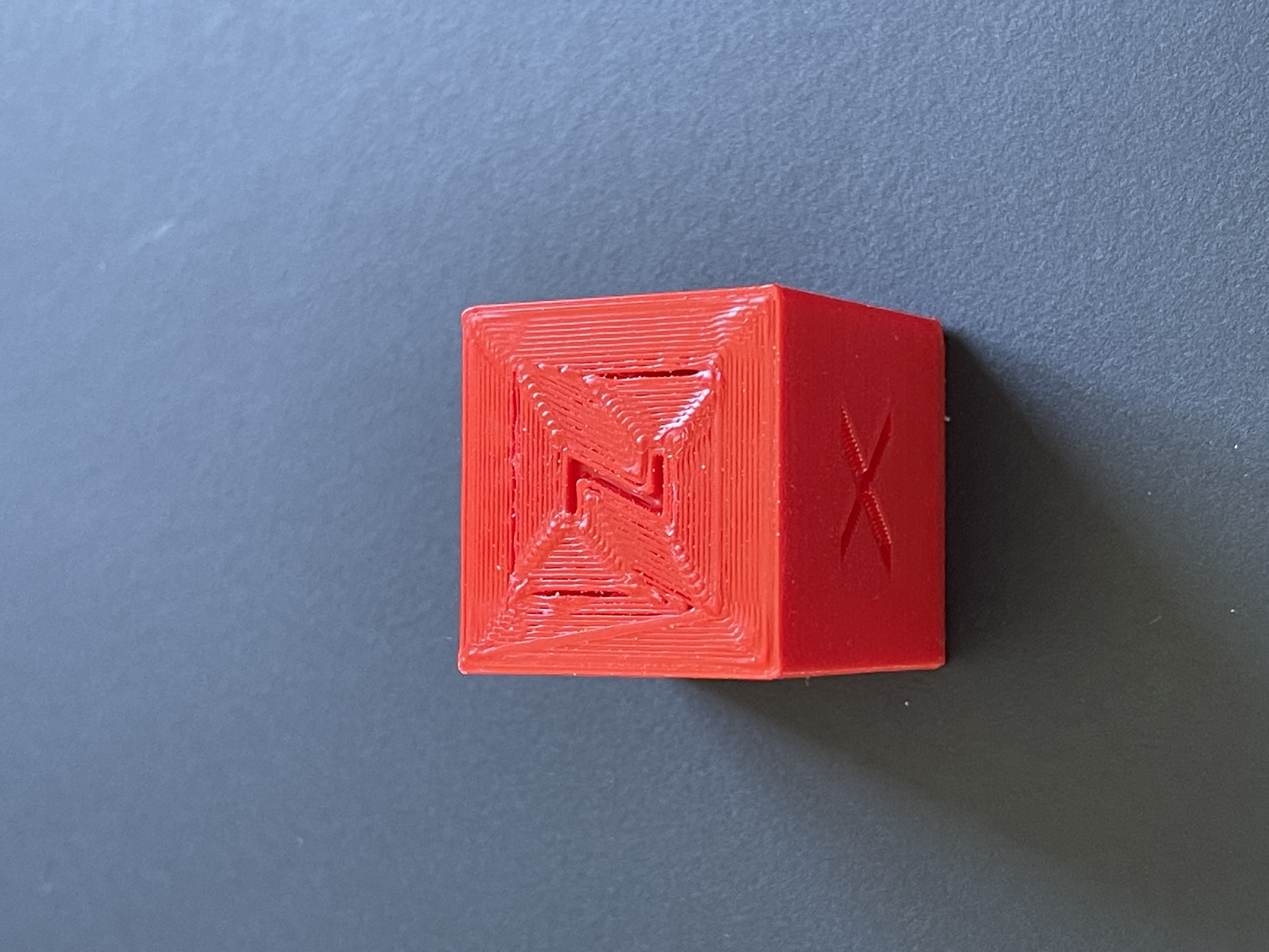

First question: I sliced and printed a cube 25mm x 25 mm with a "Z" on the top. Preview and print shows a one line width gap on both sides of the "Z".
Is this a slicing error or a wrong parameter?

Beside that the slicing pattern for the to layer creats an ugly surface. Can I chose a different pattern?

Welcome to the Simplify3D community forum! This "artifacting" is a result of the selected "Infill --> external fill pattern". Switch this back to the default of "rectilinear" and you shouldn't see near as many gaps on the top surface.
