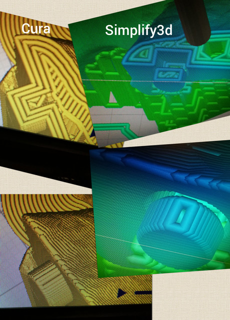

Hey,
Im new to the whole 3D printing scene so i definetly dont know what ive done wrong here.
On both sofrware i used the exact same model. I added the pins on meshmixer.
Cura slices the model as one but Simplify3D sees the pin and the model as two separete models. Why and how can i fix it?
Re: Simplify3d doesnt see the model as one?
Posted: Fri Aug 27, 2021 7:51 am
by tonyno
The model is likely bad so try repairing it.
Can also try Process Settings, Advanced, Merge all outlines into a single solid model.
Posted: Fri Aug 27, 2021 2:47 pm
by dkightley
Mesh menu ----Separate Connected Surfaces. Select with model highlighted & the issue will be resolved.
