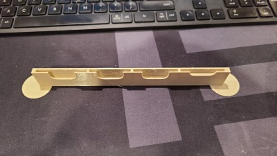

I've got a design that has one section where the walls are pretty tight and there is a fair amount of small movements. The rest of the model is very open. Basically, it is a box with one side where there are slots designed into the side. See below.
The issue is that when printing the side with the slots, the print shows tons of blobs and potentially vibrations that mess up the print, just for the time the slots are being printed. below and above the slots, everything prints fine.

To cut to the chase, here is one example of the issue. (I sliced up the Fusion 360 model to just print the wall with the slots and the issue shows up no problem)
The models are all printed with the long (slot) side along the X axis, although I'm trying a rotated print with the long side on the Y axis.
I've looked at some of the settings for slowing for short layers, but the entire layer is fairly large, it is just this one section of the layer that has the issue.
