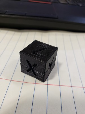

We just got it going, but are having quality issues. At certain layers we have filament bulging out and generally poor finish.
On the larger cubes we had the problems near the top & bottom. On the smaller cube we turned the temp up to 225 from 215 and decreased the multiplier from 1 to .9. Nozzle size is .6mm.
The defect is commonly seen (but not always) at the same height.
Any ideas?

Could be cooling? What filament is that and what cooling settings are you running? What's your print speed? Try decreasing it to see if giving the filament additional time to cool helps.
Are you printing a single perimeter?

Could be cooling. I had the fan off for repairs. I recently repositioned it to a lower position.
3D FUEL STANDARD PLA+, set to all the recommended settings.
Have not been able to make another print as this POS machine lost it's settings again!
I'll let you know once I get it going again.

There may be cooling problems or drafts in the room. I don't have much printing experience, but one day I opened the window (it was quite hot inside, but cold outside) the layers printed at that time were like this.

Turns out they released some g code updates and macro updates (including moving the Z offset to the probe settings....duh!)
That fixed this problem.
How have they been selling these machines with bad software?

I had this problem. I printed a cube several times, with different temperatures, but it turned out that the whole problem was in the belts. I tightened all the belts, just in case, because I read somewhere that such a 'bug' can happen. Backlash - perhaps along the Z-axis due to flexible couplings, which, in fact, would be nice to change to rigid ones.

Actually, I had exactly the same issue and couldn't shake the problem no matter what I tried. I switched to CURA 5 and was shocked to discover the problem disappeared. I'm not kidding. I have no idea what Simplify3D does with the gcode, but I'm running it through CURA 5, or even the Cura engine on my Raspberry Pi running Octobprint and slicing it with that...the results are always better.
Strange but true. I'd say just try and see what the results are like. I was genuinely surprised.
