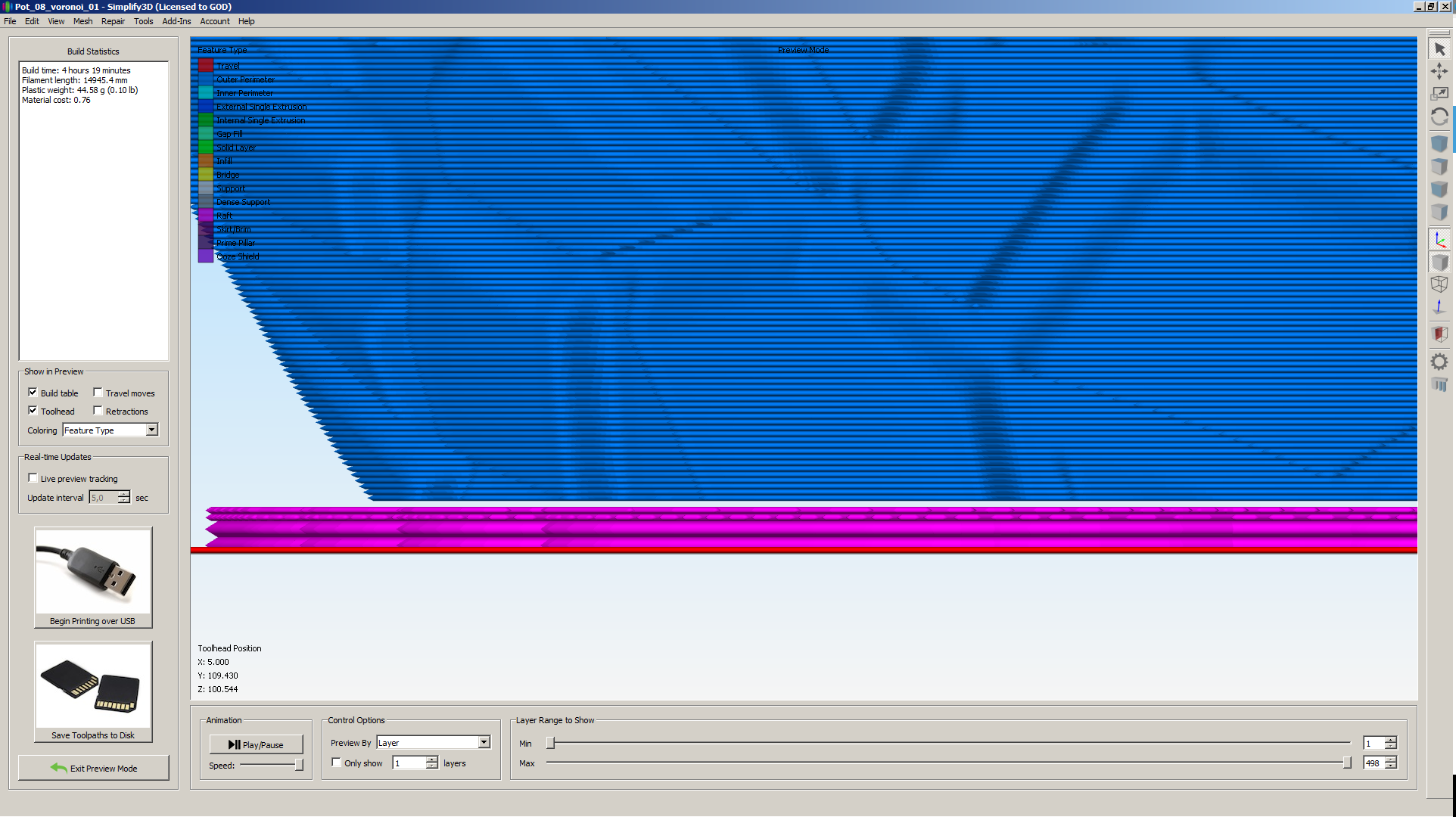

Guys,
please help me to figure out why I am getting one-lyer gap between model and raft. Model's bottom is below the XY plane, I have checked all settings many times.
Model printing well, but I am afraid that this is not reliable and some problems are possible in future.
Thanks in advance.

yesbird wrote: Thu May 26, 2022 7:06 am Guys,
https://www.simplify3d.com/support/arti ... and-brims/
"Separation Distance – This is an important setting that defines the height of the air gap between the raft and your part. Typically, having a gap of at least 0.1mm will help keep the part connected to the raft,"

Thank you, parallyze, now I can control it.
