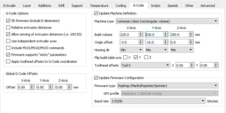

I am having offset issues with Microswiss direct drive on an ender 3. prints are not centered on bed and initial nozzle wipe is in front of the build plate. i have tried a few things but nothing seems to be helping so if anyone could see if the attached settings are correct or incorrect or put me in another direction it would be greatly appreciated.

I have also changed the Gcode Origin offset from the original setting of zero for all to
X-axis -3.0
Y=axis -16
This has put the print closer to center but has also reduced the print size and on a larger print the rear edge part on the Y axis is cut off

Have you already read this FAQ topic?
https://www.simplify3d.com/resources/faq/#quest-6324
It addresses the same issue and gives some tips on how to determine the correct offsets. I tend to do a G28 XY homing movement, mark the location of the toolhead, then do a G1 X0 Y0 F1200 move and mark where the toolhead ends up. The difference between those 2 marks is essentially the correct origin offset.
