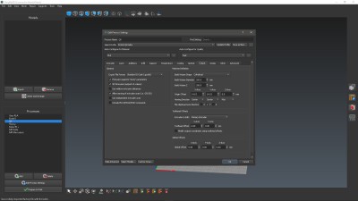

See attached image for screenshots. When one process is selected in the process list, in the next pop-up window, by default ALL of the processes are selected. This is a big change since V4 and will definitely lead to mistakes in our workflow. Please fix it/revert it back to the way V4 worked.

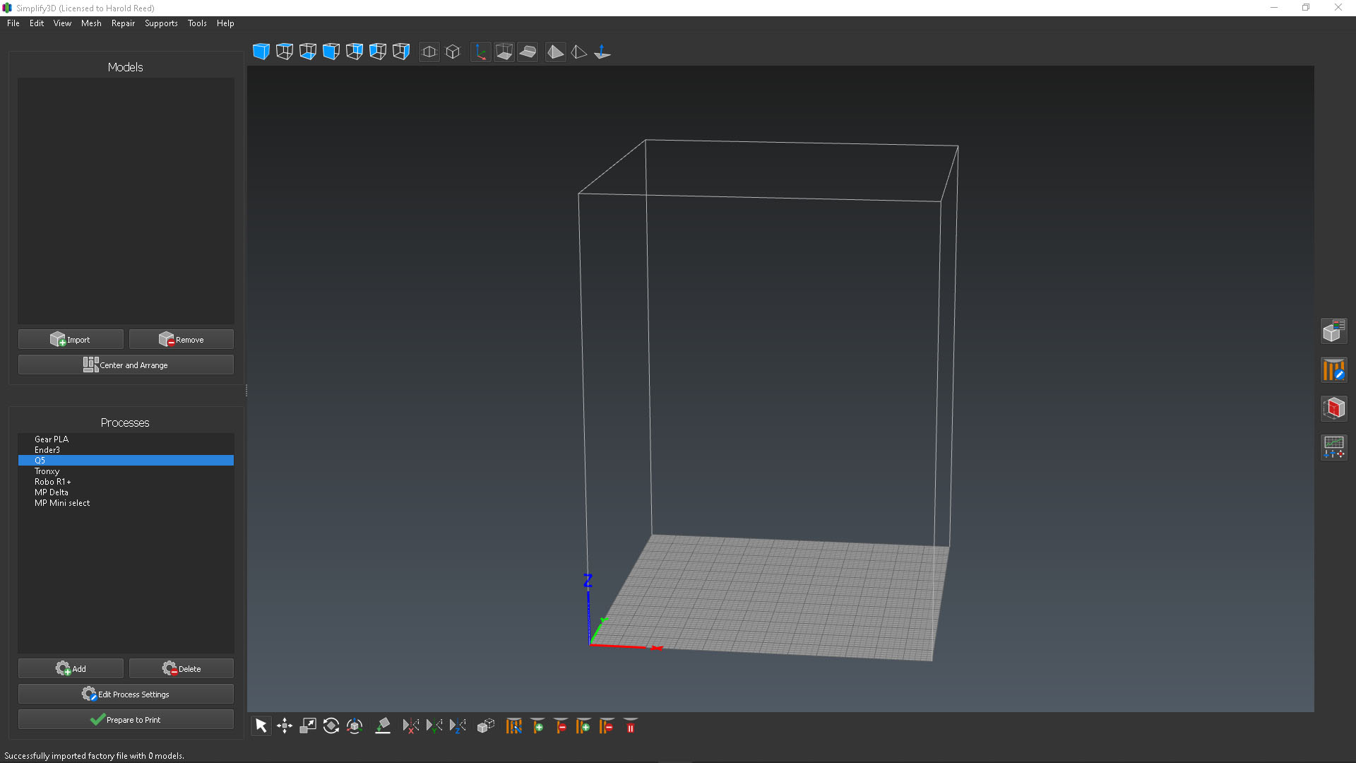

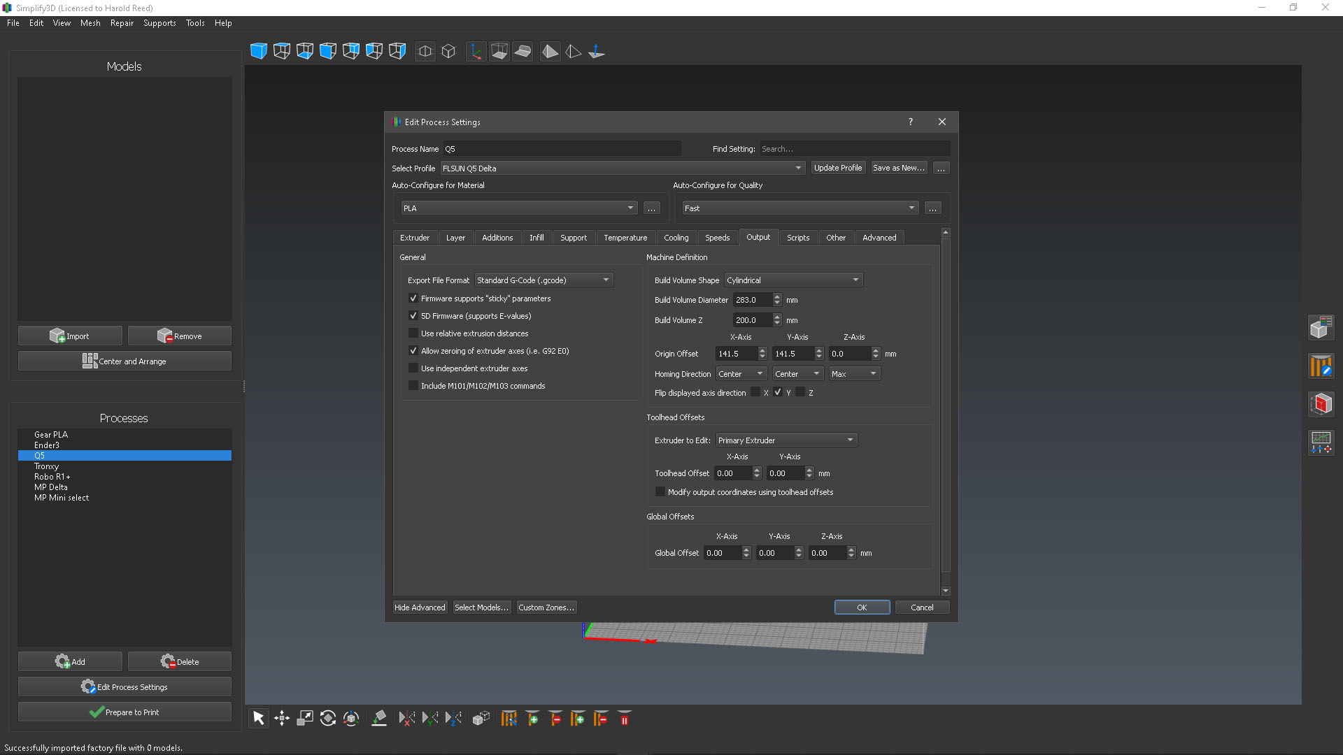

My problem related to this is for me to get a build plate visual to display I have to close the program on with the selected process then reopen. If I don't do it this way I get this.. Hard to do a delta based printer print with a square build plate.

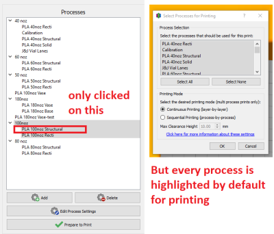

S3D-Jason wrote: ↑Thu Dec 15, 2022 1:11 pm I saw your screenshot. Can you let us know what all the different processes in that list represent? Are they different settings you are trying to save, or do they correspond with actual parts on the print bed?
The other processes are for different variations of how we may print the part. We typically only pick one process to actually slice with. The way the UI works now is setting us to make mistakes.
Not intending to dig into a UI discussion, but the way S3D has multiple printer support is terrible and is setting us up for failure. We have over 10 different types of FDM machines and typically have a master factory file setup for each hardware configuration (other than nozzle sizes) for "starting points" for each type of material/nozzle size we use on that printer. For instance, in the screenshot, this factory file is for our CR10-Max with Bondtech extruder and each starting point for the various nozzle sizes. We have had literally zero accidental slicing for the wrong machine in the past year on about 60 printers in the lab and I do not want to reinvent our work flow because it works extremely well.
